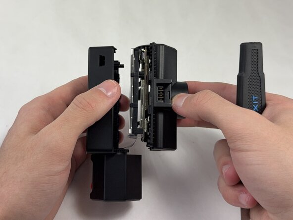

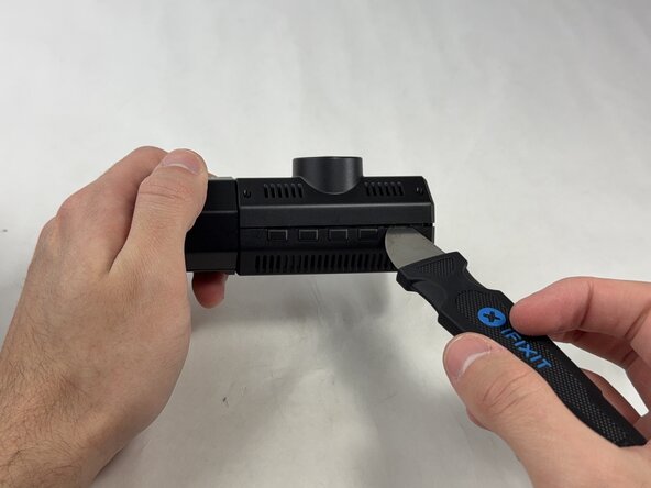

    • Use a Phillips #00 screwdriver to remove the four 1.6 mm screws on the front plate.
    • Gently insert a pry between the front panel and the main body, working around the edges to pop it off.
    • Pull the main body from the shell.
    • Be careful not to damage the ribbon cable, as they are very fragile. Ribbon cables look like thin pieces of silver duct-tape.

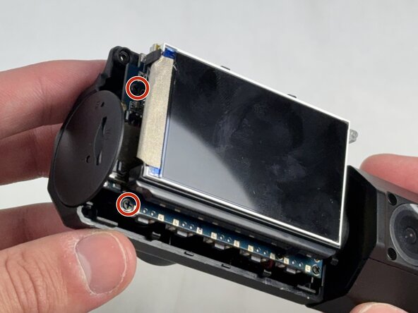

    • Use a Phillips #00 screwdriver to remove the four 1.6 mm screws that secure the screen.

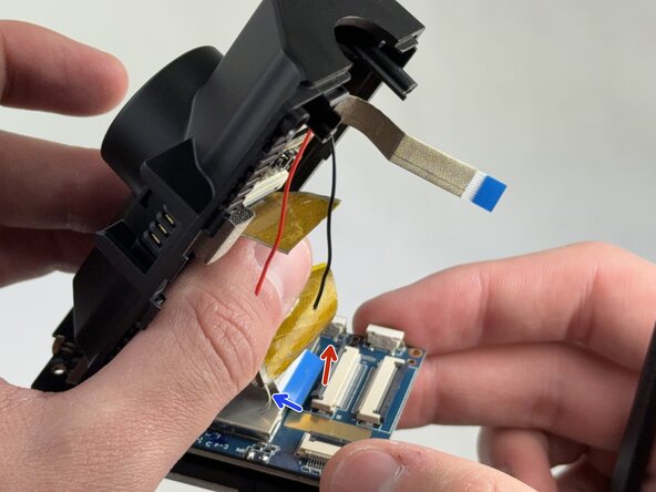

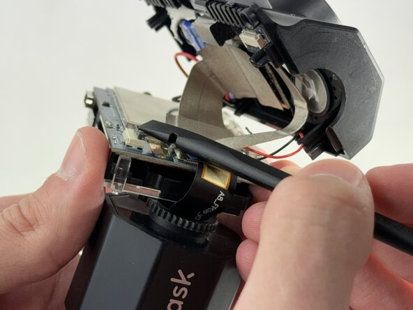

    • Remove the internal facing camera with care not to strain the connected ribbon cable.
    • Lift up the black ZIF locking flap and disconnect the ribbon cable.

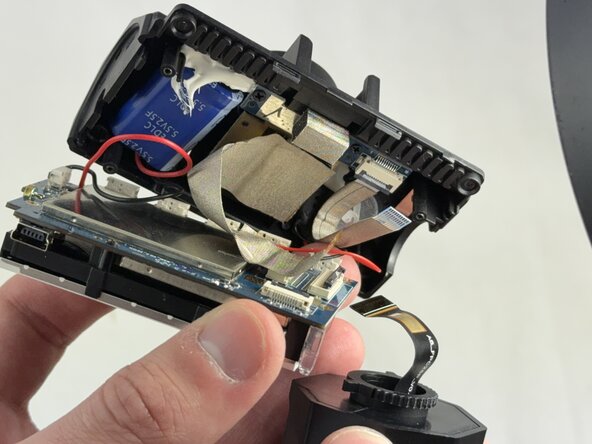

  4. Abask A8 Internal Assembly Replacement: crwdns2935265:04crwdnd2935265:01crwdnd2935265:03crwdne2935265:0 Abask A8 Internal Assembly Replacement: crwdns2935265:04crwdnd2935265:02crwdnd2935265:03crwdne2935265:0 Abask A8 Internal Assembly Replacement: crwdns2935265:04crwdnd2935265:03crwdnd2935265:03crwdne2935265:0
    • Lift the camera connector ZIF locking flap.
    • Gently remove the ribbon cable from the connector and fully remove the camera.

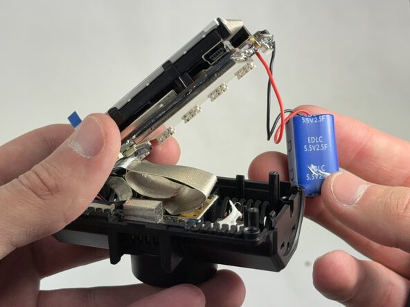

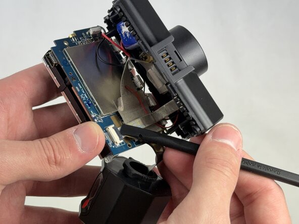

    • Using a Jimmy prying tool, lift the supercapacitor out of its slot.
    • Be careful not to puncture the supercapacitor.
