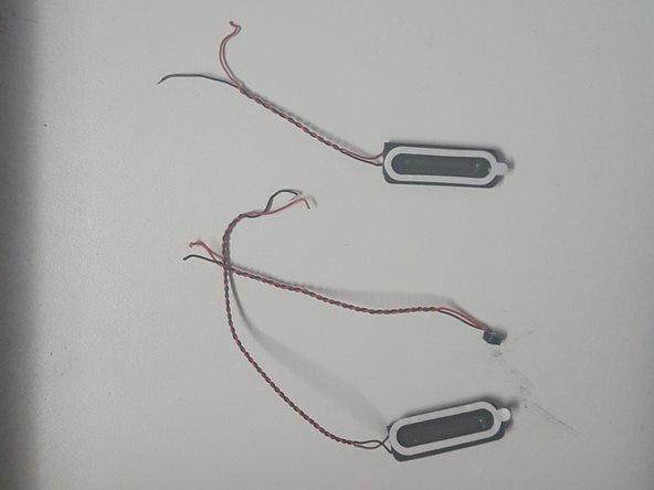

Aarp RealPad MA7BX2 Speakers Replacement
  1. Aarp RealPad MA7BX2 Speakers Replacement, Speakers: crwdns2935265:01crwdnd2935265:01crwdnd2935265:01crwdne2935265:0
    • Loosen the back cover using the suction cup.
    • Pull up on all four corners of the back with the suction cup.
  2. Aarp RealPad MA7BX2 Speakers Replacement: crwdns2935265:02crwdnd2935265:01crwdnd2935265:01crwdne2935265:0
    • Gently place the small opening tool in the crevice created by loosening the back.
    • Slide the opening tool around the edges of the device.
    • Wedge it open using the plastic opening tool.
  3. Aarp RealPad MA7BX2 Speakers Replacement: crwdns2935265:03crwdnd2935265:01crwdnd2935265:01crwdne2935265:0
    • Gently pull off the black tape.
  4. Aarp RealPad MA7BX2 Speakers Replacement: crwdns2935265:04crwdnd2935265:01crwdnd2935265:01crwdne2935265:0
    • Remove the wires with the tweezers by pulling them upward.
  5. Aarp RealPad MA7BX2 Speakers Replacement: crwdns2935265:05crwdnd2935265:01crwdnd2935265:02crwdne2935265:0 Aarp RealPad MA7BX2 Speakers Replacement: crwdns2935265:05crwdnd2935265:02crwdnd2935265:02crwdne2935265:0
    • Pull the speakers upward with you hand.
To reassemble your device you will need to solder the wires back in position and then follow the other steps in reverse order.
