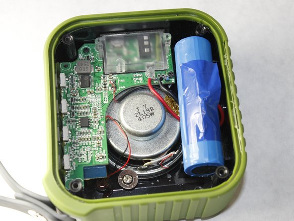

  4. AYL SoundFit Speaker Replacement: crwdns2935265:04crwdnd2935265:01crwdnd2935265:02crwdne2935265:0 AYL SoundFit Speaker Replacement: crwdns2935265:04crwdnd2935265:02crwdnd2935265:02crwdne2935265:0
    • Remove the two Phillips screws which hold its battery casing on the housing using a PH00 Phillips screwdriver.
    • Remove the battery case to reveal the battery.

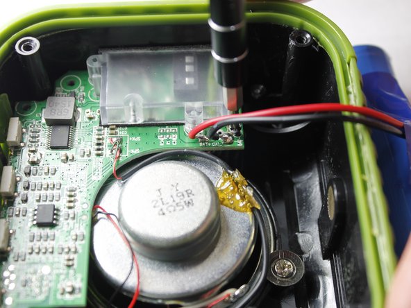

  5. AYL SoundFit Speaker Replacement: crwdns2935265:05crwdnd2935265:01crwdnd2935265:01crwdne2935265:0
    • Using a soldering iron, heat up and remove both the positive and negative battery contacts from the motherboard.

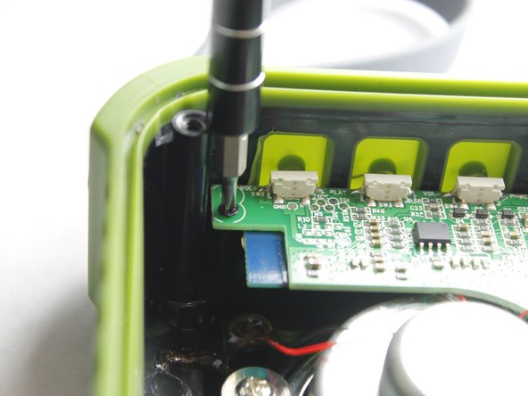

  6. AYL SoundFit Speaker Replacement: crwdns2935265:06crwdnd2935265:01crwdnd2935265:03crwdne2935265:0 AYL SoundFit Speaker Replacement: crwdns2935265:06crwdnd2935265:02crwdnd2935265:03crwdne2935265:0 AYL SoundFit Speaker Replacement: crwdns2935265:06crwdnd2935265:03crwdnd2935265:03crwdne2935265:0
    • Remove all three Phillips screws which holds the motherboard to the base using a PH00 Phillips screwdriver.
    • The motherboard can now be wiggled free from the base.
