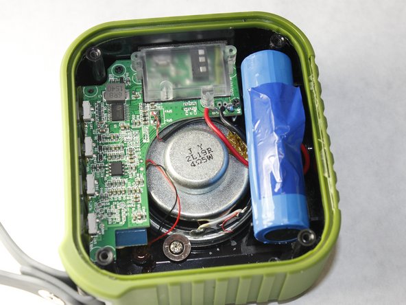

    • Remove the four hex screws on the top of the device using a 2.5 hex screwdriver.
  2. AYL SoundFit Battery Replacement: crwdns2935265:02crwdnd2935265:01crwdnd2935265:01crwdne2935265:0
    • Place a spudger between the black plastic cover and the green case.
    • Pry the black cover away from the main casing and remove the cover.
  3. AYL SoundFit Battery Replacement: crwdns2935265:03crwdnd2935265:01crwdnd2935265:01crwdne2935265:0
    • Place a spudger between the black housing, which contains the woofer, and the outer rubber casing.
    • Pry the housing away from the body to reveal the motherboard, speaker, and battery.
  4. AYL SoundFit Battery Replacement: crwdns2935265:04crwdnd2935265:01crwdnd2935265:02crwdne2935265:0 AYL SoundFit Battery Replacement: crwdns2935265:04crwdnd2935265:02crwdnd2935265:02crwdne2935265:0
    • Remove the two Phillips #00 screws securing the battery casing.
    • Remove the battery case to reveal the battery.
  5. AYL SoundFit Battery Replacement: crwdns2935265:05crwdnd2935265:01crwdnd2935265:01crwdne2935265:0
    • Desolder the positive and negative battery contacts from the motherboard.
    • Remove the battery from the device.

Which battery is this, and what is the mAH?
jlongsa - crwdns2934203:0crwdne2934203:0
3.7V 1500mAh, 5.55Wh
