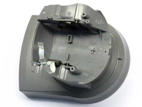

    • Take out the screw under the lens. Gently tilt front upwards and remove.
  3. AXIS 213 PTZ Network Camera Capacitor Replacement: crwdns2935265:03crwdnd2935265:01crwdnd2935265:03crwdne2935265:0 AXIS 213 PTZ Network Camera Capacitor Replacement: crwdns2935265:03crwdnd2935265:02crwdnd2935265:03crwdne2935265:0 AXIS 213 PTZ Network Camera Capacitor Replacement: crwdns2935265:03crwdnd2935265:03crwdnd2935265:03crwdne2935265:0

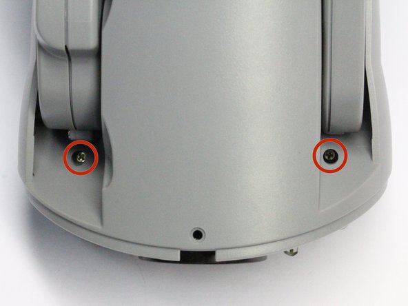

    • Take out the 2 screws (painted grey) out at the back end bottom.
    • Take out the 2 screws at the front end bottom.

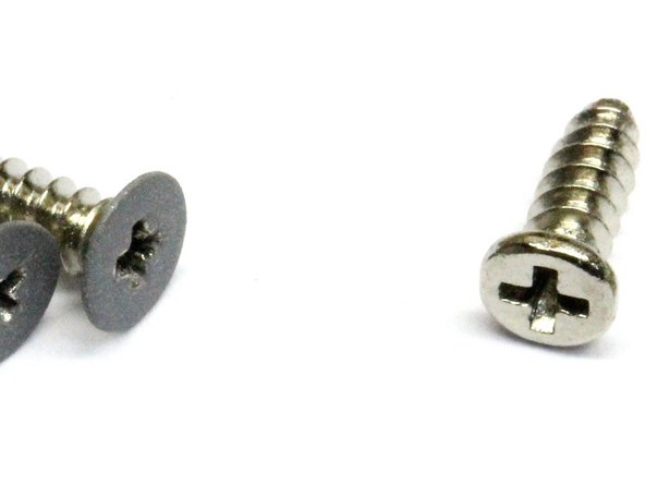

    • You now have 5 screws of which 3 with grey painted heads. For reassembly, use them wisely. :)

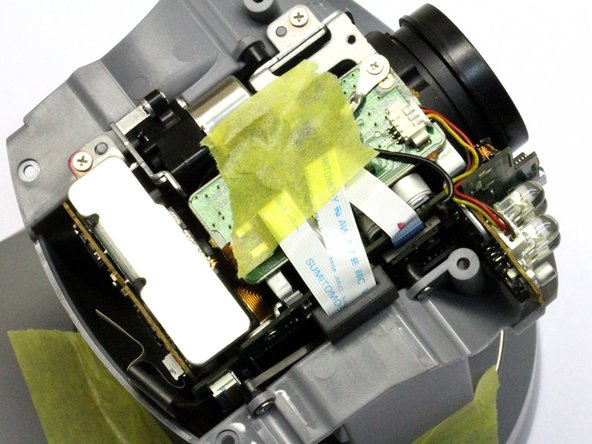

    • Gently lift the housing top, and slide it back while lifting.
    • You will find the whole camera module wrapped in thick cellophane. For reasons of heat dispersal and prolonged life, I would recommend disposing of it during following steps. But only if your camera is for indoor use ! Outdoor cams might benefit from the wrapping, containing the heat in the camera module, preventing condensation/corrosion.
    • Optional : for reassembly, some adhesive tape might come in handy to hold down the flat cables.

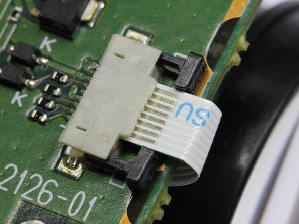

    • We will now disconnect the 2 flatcables that connect the camera module to the camera base.
    • The ferrite core is attached to the left cable connector with some 2-sided sticky tape. Gently pry it loose so it can slide upward along the cables. Now is a good time to mark which cable goes in which socket.
    • The 2 brown/white cable connectors can now be reached. The brown part has to slide UP. Pry it loose with a very fine instrument : bit on the left, bit on the right, and repeat until loose. It should remain seated in the connector body. If it's no longer clamped, you're far enough ! FRAGILE !

    • Take out the two screws holding the camera module to the plastic housing.
    • You can now lift the whole camera module straight up to remove it from the housing.
    • At reassembly, before tightening the screws, make sure the round plastic notches are well seated in the metal bracket's holes.

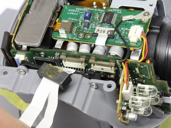

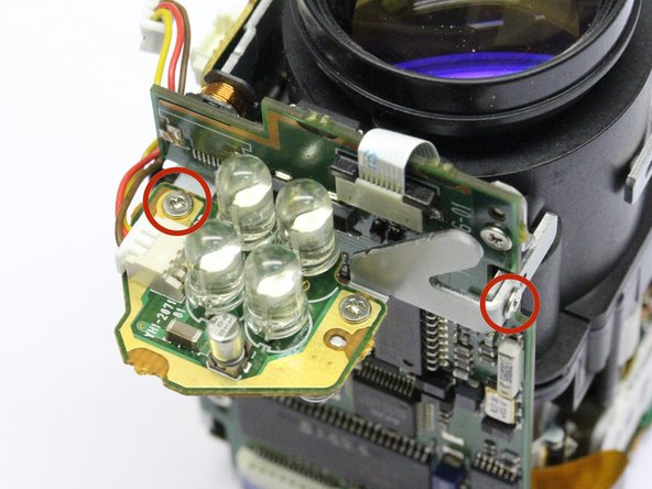

    • Now the infrared light module is to be removed in order to gain acces to the board we need.
    • Gently slide out the white connector.
    • Remove the two screws, and remove the light module.

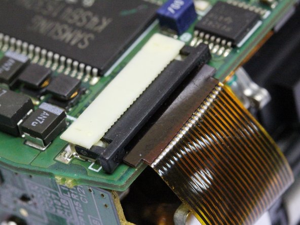

    • Disconnect the right ribbon cable. Hook your fingernails behind the right and left notches of the black connector part, and pull it towards the white ribbon cable with even and L/R balanced force until loose. FRAGILE ! The cable will slide out easily.
    • For reassembly : notice this cable is ON TOP of the black connector wedge. Insert the cable as intended, and push the black wedge back in place, again balancing force left and right.
  9. AXIS 213 PTZ Network Camera Capacitor Replacement: crwdns2935265:09crwdnd2935265:01crwdnd2935265:02crwdne2935265:0 AXIS 213 PTZ Network Camera Capacitor Replacement: crwdns2935265:09crwdnd2935265:02crwdnd2935265:02crwdne2935265:0
    • Disconnect the bottom left ribbon cable. Hook your fingernails behind the right and left notches of the black connector part, and pull it towards the brown ribbon cable with even and L/R balanced force until loose. FRAGILE ! The cable will slide out easily.
    • For reassembly : notice this cable is UNDER the black connector wedge. Put the cable back in place, and push the black wedge back in, again balancing force left and rigt.

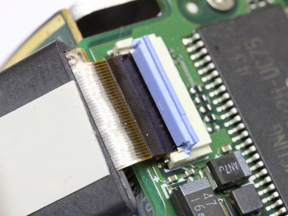

    • To disconnect the left top ribbon cable, tilt up the blue connector part, and hinge it up 90°. The cable will slide out easily.
    • To reassemble : position the cable and tilt the blue part down again.

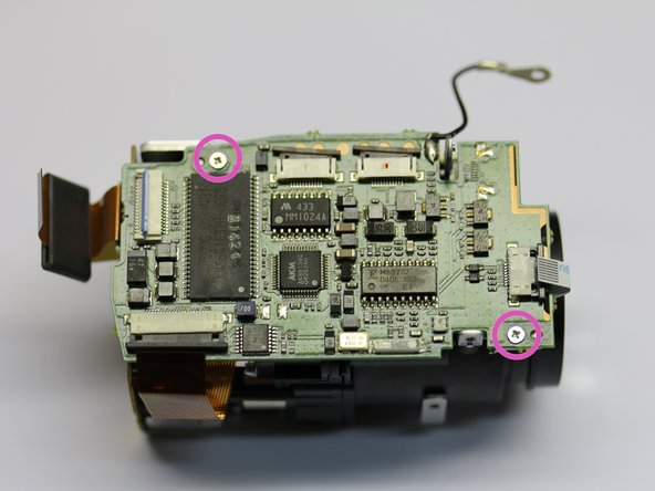

    • Remove the screw from the ground terminal.
    • Remove the two screws holding the board.
  12. AXIS 213 PTZ Network Camera Capacitor Replacement: crwdns2935265:012crwdnd2935265:01crwdnd2935265:01crwdne2935265:0
    • The board is now free for replacing the 6 capacitors.
