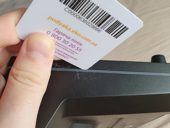

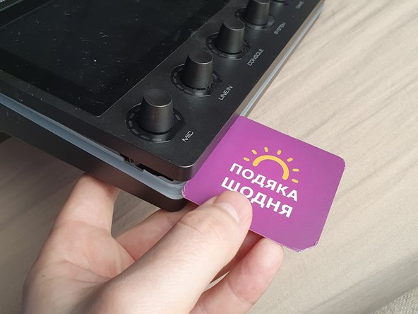

  3. AVerMedia NEXUS AX310 Teardown, Latches: crwdns2935265:03crwdnd2935265:01crwdnd2935265:03crwdne2935265:0 AVerMedia NEXUS AX310 Teardown, Latches: crwdns2935265:03crwdnd2935265:02crwdnd2935265:03crwdne2935265:0 AVerMedia NEXUS AX310 Teardown, Latches: crwdns2935265:03crwdnd2935265:03crwdnd2935265:03crwdne2935265:0
    • Unclick latches using long side of credit card. I recomend this because latches are really strong and not flexible, so this wat to do this will help to keep them alive
    • You need to do this above rgb line
    • Do both sides and bottom, after that upper side will free itself.
    • Do not pull upper half of streamer as it connected to bottom with wires

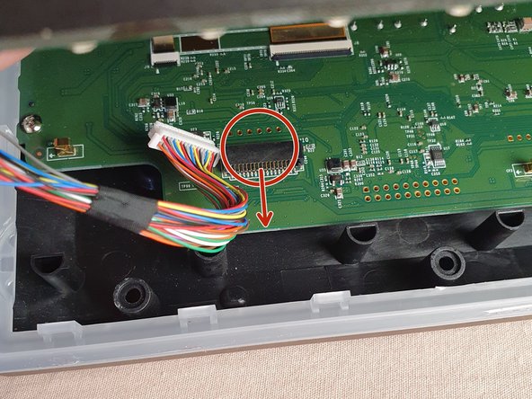

  4. AVerMedia NEXUS AX310 Teardown, Bottom wire: crwdns2935265:04crwdnd2935265:01crwdnd2935265:02crwdne2935265:0 AVerMedia NEXUS AX310 Teardown, Bottom wire: crwdns2935265:04crwdnd2935265:02crwdnd2935265:02crwdne2935265:0
    • Lift bottom side and make colorful wire visible and acceseble
    • Unplug it. This part do not have any clips, so gust push it down

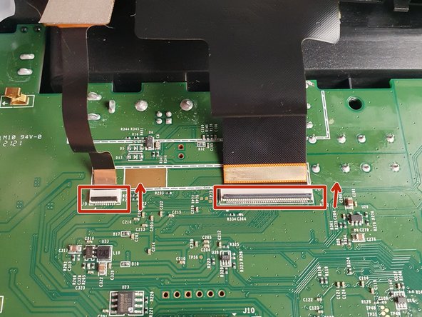

  5. AVerMedia NEXUS AX310 Teardown, Unplug screen wire: crwdns2935265:05crwdnd2935265:01crwdnd2935265:02crwdne2935265:0 AVerMedia NEXUS AX310 Teardown, Unplug screen wire: crwdns2935265:05crwdnd2935265:02crwdnd2935265:02crwdne2935265:0
    • Flip bottom half of streamer more and make display and touchscreen plumes visible
    • Remove black isolation (if you have it) on bottom pcb
    • Lift black lockers
    • Remove plumes

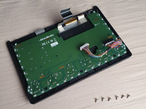

  6. AVerMedia NEXUS AX310 Teardown, Upper part screw remove: crwdns2935265:06crwdnd2935265:01crwdnd2935265:02crwdne2935265:0 AVerMedia NEXUS AX310 Teardown, Upper part screw remove: crwdns2935265:06crwdnd2935265:02crwdnd2935265:02crwdne2935265:0
    • Remove 6 PH1 screws on top
    • Im done on this, because my goal was to check any marks on screen. I think to fully remove top pcb you need to remove bottom parts of audio spinnerы but i cannot do it
