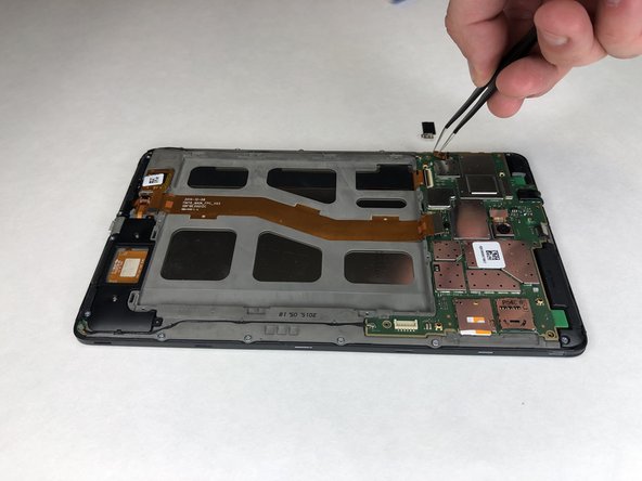

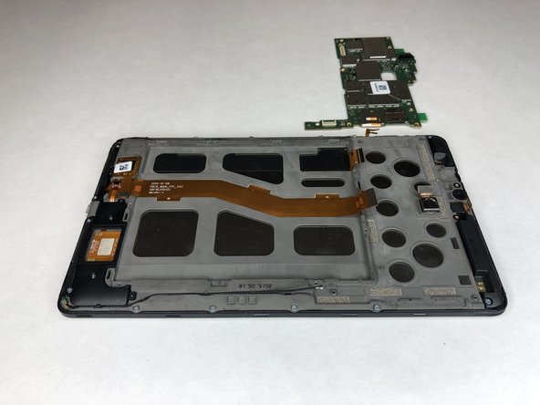

    1. ATT Trek HD 9020A Screen Replacement, Motherboard: crwdns2935265:05crwdnd2935265:01crwdnd2935265:02crwdne2935265:0 ATT Trek HD 9020A Screen Replacement, Motherboard: crwdns2935265:05crwdnd2935265:02crwdnd2935265:02crwdne2935265:0
      • Using a Phillips #00 screwdriver, remove the seven 1 mm screws on the green perimeter of the motherboard.
    2. ATT Trek HD 9020A Screen Replacement: crwdns2935265:06crwdnd2935265:01crwdnd2935265:02crwdne2935265:0 ATT Trek HD 9020A Screen Replacement: crwdns2935265:06crwdnd2935265:02crwdnd2935265:02crwdne2935265:0
      • Use the plastic opening tool to disconnect the large gold strip underneath the metal plate from the motherboard.
    3. ATT Trek HD 9020A Screen Replacement: crwdns2935265:07crwdnd2935265:01crwdnd2935265:01crwdne2935265:0
      • Use the plastic opening tool to disconnect the front and back cameras from motherboard.
    4. ATT Trek HD 9020A Screen Replacement: crwdns2935265:08crwdnd2935265:01crwdnd2935265:02crwdne2935265:0 ATT Trek HD 9020A Screen Replacement: crwdns2935265:08crwdnd2935265:02crwdnd2935265:02crwdne2935265:0
      $3.99
      • Use angled tweezers to pry up the black tab.
      • Use the angled tweezers to pull out the gold connector.
    5. ATT Trek HD 9020A Screen Replacement: crwdns2935265:09crwdnd2935265:01crwdnd2935265:02crwdne2935265:0 ATT Trek HD 9020A Screen Replacement: crwdns2935265:09crwdnd2935265:02crwdnd2935265:02crwdne2935265:0
      • Use the angled tweezers to disconnect the gold connector.
    6. ATT Trek HD 9020A Screen Replacement: crwdns2935265:010crwdnd2935265:01crwdnd2935265:01crwdne2935265:0
      • Use the plastic opening tool to disconnect the black connectors on each side of the motherboard.
    7. ATT Trek HD 9020A Screen Replacement: crwdns2935265:011crwdnd2935265:01crwdnd2935265:02crwdne2935265:0 ATT Trek HD 9020A Screen Replacement: crwdns2935265:011crwdnd2935265:02crwdnd2935265:02crwdne2935265:0
      • Use the plastic opening tool to lift the motherboard out of place.

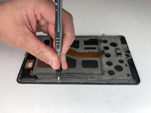

    1. ATT Trek HD 9020A Screen Replacement, Screen: crwdns2935265:013crwdnd2935265:01crwdnd2935265:03crwdne2935265:0 ATT Trek HD 9020A Screen Replacement, Screen: crwdns2935265:013crwdnd2935265:02crwdnd2935265:03crwdne2935265:0 ATT Trek HD 9020A Screen Replacement, Screen: crwdns2935265:013crwdnd2935265:03crwdnd2935265:03crwdne2935265:0
      • Use the Phillips #00 screwdriver to remove the six 3 mm screws holding the black plastic corner pieces in place.
      • Gently lift the black corner pieces out of the device.
    2. ATT Trek HD 9020A Screen Replacement: crwdns2935265:014crwdnd2935265:01crwdnd2935265:02crwdne2935265:0 ATT Trek HD 9020A Screen Replacement: crwdns2935265:014crwdnd2935265:02crwdnd2935265:02crwdne2935265:0
      $3.99
      • Use the angled tweezers to remove the black cables on each side of the device from their groove.
    3. ATT Trek HD 9020A Screen Replacement: crwdns2935265:015crwdnd2935265:01crwdnd2935265:02crwdne2935265:0 ATT Trek HD 9020A Screen Replacement: crwdns2935265:015crwdnd2935265:02crwdnd2935265:02crwdne2935265:0
      • Use the plastic opening tool to disconnect the black cable connectors from each side of the device.
    4. ATT Trek HD 9020A Screen Replacement: crwdns2935265:016crwdnd2935265:01crwdnd2935265:02crwdne2935265:0 ATT Trek HD 9020A Screen Replacement: crwdns2935265:016crwdnd2935265:02crwdnd2935265:02crwdne2935265:0
      • Remove the remaining ten 3 mm Phillips #00 screws.

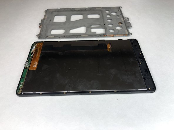

    5. ATT Trek HD 9020A Screen Replacement: crwdns2935265:017crwdnd2935265:01crwdnd2935265:02crwdne2935265:0 ATT Trek HD 9020A Screen Replacement: crwdns2935265:017crwdnd2935265:02crwdnd2935265:02crwdne2935265:0
      • Use the plastic opening tool to disconnect the remaining three gold connectors at the bottom of the device.
    6. ATT Trek HD 9020A Screen Replacement: crwdns2935265:018crwdnd2935265:01crwdnd2935265:02crwdne2935265:0 ATT Trek HD 9020A Screen Replacement: crwdns2935265:018crwdnd2935265:02crwdnd2935265:02crwdne2935265:0
      • Use the plastic opening tool to pry up the grey plastic panel.
    7. ATT Trek HD 9020A Screen Replacement: crwdns2935265:019crwdnd2935265:01crwdnd2935265:02crwdne2935265:0 ATT Trek HD 9020A Screen Replacement: crwdns2935265:019crwdnd2935265:02crwdnd2935265:02crwdne2935265:0
      • Use the plastic opening tool to pry the screen out of the device.
