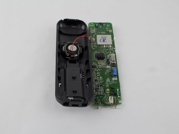

    1. ATT EL52300 Motherboard Replacement, Motherboard: crwdns2935265:03crwdnd2935265:01crwdnd2935265:02crwdne2935265:0 ATT EL52300 Motherboard Replacement, Motherboard: crwdns2935265:03crwdnd2935265:02crwdnd2935265:02crwdne2935265:0
      • Remove the two 3.75 mm screws with a PH1 screwdriver.

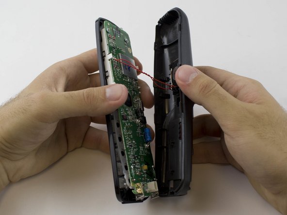

    2. ATT EL52300 Motherboard Replacement: crwdns2935265:04crwdnd2935265:01crwdnd2935265:02crwdne2935265:0 ATT EL52300 Motherboard Replacement: crwdns2935265:04crwdnd2935265:02crwdnd2935265:02crwdne2935265:0
      • Use a plastic opening tool to remove the handset case.
      • Be careful to not lift the case too far as the ringer cable is attached to the case.
    3. ATT EL52300 Motherboard Replacement: crwdns2935265:05crwdnd2935265:01crwdnd2935265:02crwdne2935265:0 ATT EL52300 Motherboard Replacement: crwdns2935265:05crwdnd2935265:02crwdnd2935265:02crwdne2935265:0
      Anti-Static Wrist Strap
      $7.95
      • Remove the two 3.65 mm screws on the motherboard with a PH1 screwdriver.
      • Use an anti-static wrist strap to prevent damage to the motherboard.
