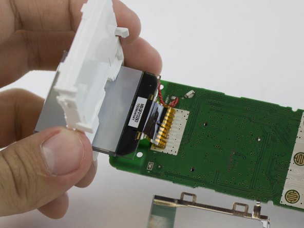

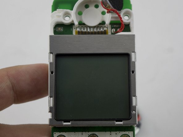

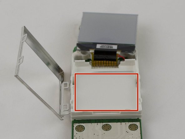

    • To get to the connection between the display and the motherboard, remove the casing for the display using a plastic opening tool.
    • The white casing has a hole cut into it. You are going to slide the display and the speaker through this hole.
  8. ATT EL52300 LCD Screen on Handset Replacement: crwdns2935265:08crwdnd2935265:01crwdnd2935265:01crwdne2935265:0
    • The display has a line of soldered connections to the motherboard. These all need to be undone with a soldering tool, so the screen can be removed.
    • Please refer to the How To Solder and Desolder Connections for soldering help.
