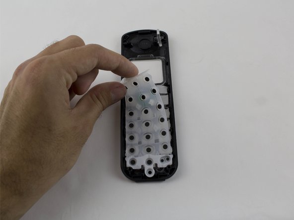

    1. ATT EL52300 Keypad/Plastic Display Screen Replacement, Keypad/Plastic Display Screen: crwdns2935265:06crwdnd2935265:01crwdnd2935265:02crwdne2935265:0 ATT EL52300 Keypad/Plastic Display Screen Replacement, Keypad/Plastic Display Screen: crwdns2935265:06crwdnd2935265:02crwdnd2935265:02crwdne2935265:0
      • The keypad lies on the top of the motherboard and is easily detachable.
      • Remove the keypad.
    2. ATT EL52300 Keypad/Plastic Display Screen Replacement: crwdns2935265:07crwdnd2935265:01crwdnd2935265:01crwdne2935265:0
      • Replace the plastic display screen, or the keypad buttons as needed.
