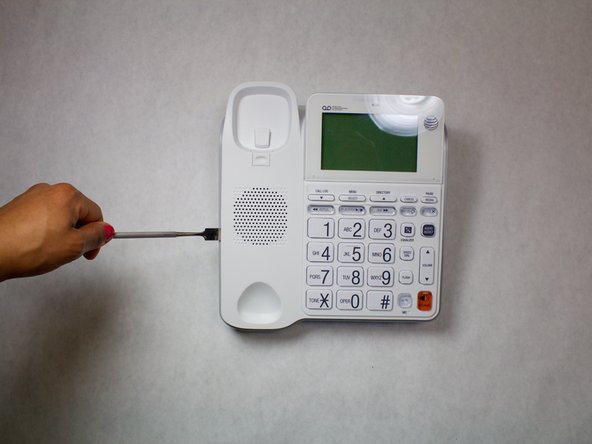

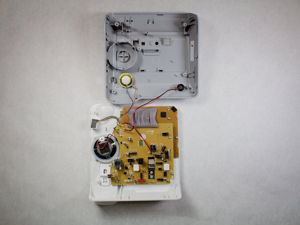

  3. ATT CL4940 Motherboard Replacement: crwdns2935265:03crwdnd2935265:01crwdnd2935265:03crwdne2935265:0 ATT CL4940 Motherboard Replacement: crwdns2935265:03crwdnd2935265:02crwdnd2935265:03crwdne2935265:0 ATT CL4940 Motherboard Replacement: crwdns2935265:03crwdnd2935265:03crwdnd2935265:03crwdne2935265:0
    • Using a metal spudger, start at the bottom of the device to separate the top cover from the back cover.
    • Work the spudger between the top and back covers of the device starting downwards, then to each side, and finally upwards.
    • There are brackets every few inches along the edge of the device which may be difficult to pull apart.
    • The top and back cover will separate and the internals will be accessible.
  4. ATT CL4940 Motherboard Replacement: crwdns2935265:04crwdnd2935265:01crwdnd2935265:01crwdne2935265:0
    • Use a bit driver to remove all five 5mm X 5mm Phillips head Motherboard screws.

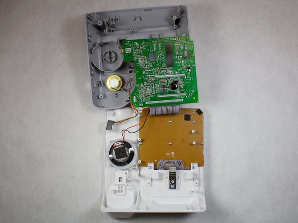

  5. ATT CL4940 Motherboard Replacement: crwdns2935265:05crwdnd2935265:01crwdnd2935265:02crwdne2935265:0 ATT CL4940 Motherboard Replacement: crwdns2935265:05crwdnd2935265:02crwdnd2935265:02crwdne2935265:0
    Desoldering Pump
    $3.99
    • Lift the motherboard upwards as shown in the first image.
    • Use a de-soldering pump to disconnect the electric wires by de-soldering them.
