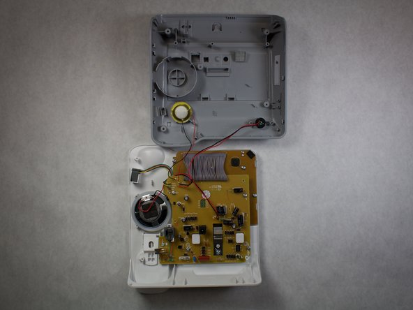

    • Unplug your device before beginning disassembly.
    • Remove phone line and power cord from the back cover of the device.
    • Remove phone cable from the side of the device.
  2. ATT CL4940 Internal Speaker Replacement: crwdns2935265:02crwdnd2935265:01crwdnd2935265:01crwdne2935265:0
    • Remove the five 4mm X 10mm Phillips head screws from the back cover of the device.
  3. ATT CL4940 Internal Speaker Replacement: crwdns2935265:03crwdnd2935265:01crwdnd2935265:03crwdne2935265:0 ATT CL4940 Internal Speaker Replacement: crwdns2935265:03crwdnd2935265:02crwdnd2935265:03crwdne2935265:0 ATT CL4940 Internal Speaker Replacement: crwdns2935265:03crwdnd2935265:03crwdnd2935265:03crwdne2935265:0
    • Starting from the bottom of the device, use a metal spudger, separate the top (white) plastic piece from the bottom (gray) plastic piece.
    • Work your way across the bottom of the device, then to each side, and finally to the top.
    • There are brackets every few inches along the edge of the device. These may be difficult to pull apart.
    • The top and bottom pieces should separate, and the internals of the device will now be accessible.
  4. ATT CL4940 Internal Speaker Replacement: crwdns2935265:04crwdnd2935265:01crwdnd2935265:01crwdne2935265:0
    • Using wire cutters, sever both the red and black wires connected to the speaker.
    • Carefully remove the speaker from the assembly.
    • Be sure to remove the rubber gasket from the broken speaker. You will need this for reassembly.
