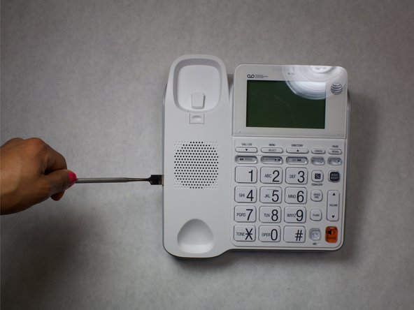

    • Starting from the bottom of the device, (using a metal spudger) separate the top (white) plastic piece from the bottom (gray) plastic piece.
    • Work your way across the bottom of the device, then to each side, and finally to the top.
    • There are brackets every few inches along the edge of the device. These may be difficult to pull apart.
    • The top and bottom pieces should separate, and the internals of the device will now be accessible.

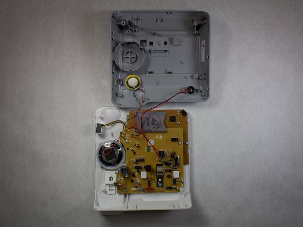

  4. ATT CL4940 Internal Microphone Replacement: crwdns2935265:04crwdnd2935265:01crwdnd2935265:01crwdne2935265:0
    • Using wire cutters, sever both the red and the black wires connected to the microphone.
    • To remove the microphone from the device, gently wiggle it while pulling it apart.
