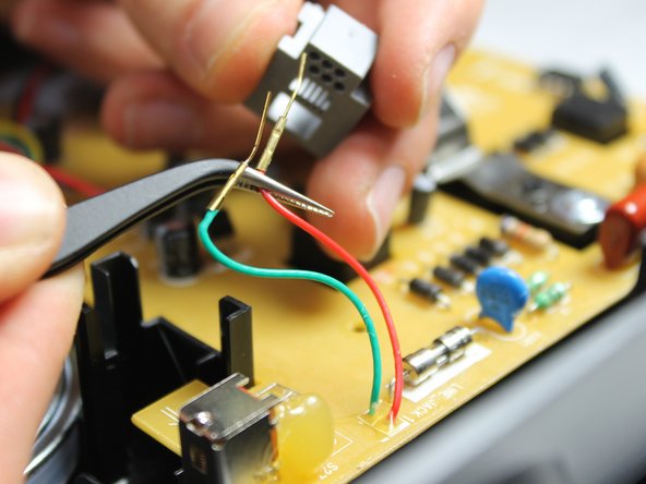

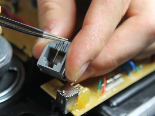

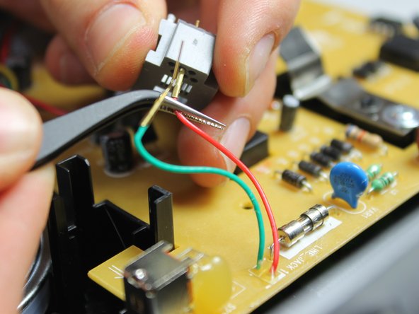

    1. ATT CL2940 Phone Jack Replacement, Phone Jack: crwdns2935265:04crwdnd2935265:01crwdnd2935265:02crwdne2935265:0 ATT CL2940 Phone Jack Replacement, Phone Jack: crwdns2935265:04crwdnd2935265:02crwdnd2935265:02crwdne2935265:0
      • Using the precision tweezers, bend the golden tips of the green and red wires upward.
      • The wires are pulled out from two of the six holes. Make sure you remember which holes you pulled the wires out from.
      • Bend the wires slowly and gently to avoid breaking them.
    2. ATT CL2940 Phone Jack Replacement: crwdns2935265:05crwdnd2935265:01crwdnd2935265:03crwdne2935265:0 ATT CL2940 Phone Jack Replacement: crwdns2935265:05crwdnd2935265:02crwdnd2935265:03crwdne2935265:0 ATT CL2940 Phone Jack Replacement: crwdns2935265:05crwdnd2935265:03crwdnd2935265:03crwdne2935265:0
      • After bending the golden wire tips, pull the wires out from the back side of the phone jack.
