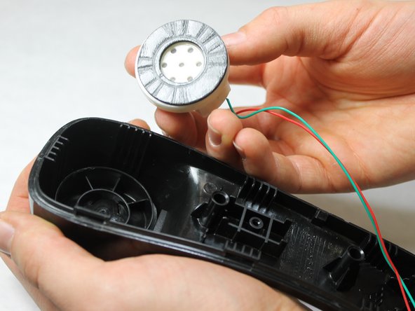

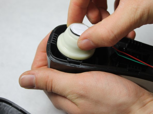

  4. ATT CL2940 Handset Speaker Replacement: crwdns2935265:04crwdnd2935265:01crwdnd2935265:03crwdne2935265:0 ATT CL2940 Handset Speaker Replacement: crwdns2935265:04crwdnd2935265:02crwdnd2935265:03crwdne2935265:0 ATT CL2940 Handset Speaker Replacement: crwdns2935265:04crwdnd2935265:03crwdnd2935265:03crwdne2935265:0
    • Pull the speaker out gently to detach it from the handset. The speaker is located at the top end of the handset. It is the circular white piece with red and greed wires connected to it.
    • The speaker is attached to the handset with a slightly sticky adhesive.

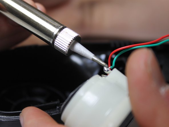

  5. ATT CL2940 Handset Speaker Replacement: crwdns2935265:05crwdnd2935265:01crwdnd2935265:02crwdne2935265:0 ATT CL2940 Handset Speaker Replacement: crwdns2935265:05crwdnd2935265:02crwdnd2935265:02crwdne2935265:0
    • Use a soldering iron to melt the existing solder off of both the red and green wires in order to completely remove the speaker.
