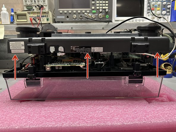

  5. AT-LP120-USB Start/Stop Button Replacement, Disassembly: Remove Bottom Cover: crwdns2935265:05crwdnd2935265:01crwdnd2935265:03crwdne2935265:0 AT-LP120-USB Start/Stop Button Replacement, Disassembly: Remove Bottom Cover: crwdns2935265:05crwdnd2935265:02crwdnd2935265:03crwdne2935265:0 AT-LP120-USB Start/Stop Button Replacement, Disassembly: Remove Bottom Cover: crwdns2935265:05crwdnd2935265:03crwdnd2935265:03crwdne2935265:0
    • Spin the turntable so that the rear is facing you.
    • Lift off the bottom cover.
    • Depending on manufacturer date, you may need to tilt the bottom cover to pull it away from the ports/switches.
    • Remove the hinges if they do not come out of the dust cover when lifting.
    • As you pull the bottom cover off, the RCA cables will be removed through this hole.

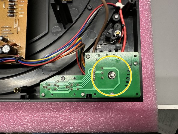

  6. AT-LP120-USB Start/Stop Button Replacement, Disassembly: Locate The Button: crwdns2935265:06crwdnd2935265:01crwdnd2935265:03crwdne2935265:0 AT-LP120-USB Start/Stop Button Replacement, Disassembly: Locate The Button: crwdns2935265:06crwdnd2935265:02crwdnd2935265:03crwdne2935265:0 AT-LP120-USB Start/Stop Button Replacement, Disassembly: Locate The Button: crwdns2935265:06crwdnd2935265:03crwdnd2935265:03crwdne2935265:0
    • Spin the turntable back around such that the front is closest to you.

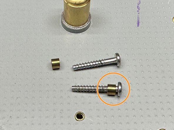

    • Locate and collect the 8 brass bushings if they did not come out with the screws.
    • Slide the bushings to the head of each screw and set aside for later.
    • The button that is being removed can be located here.

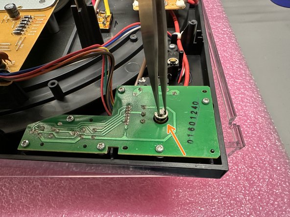

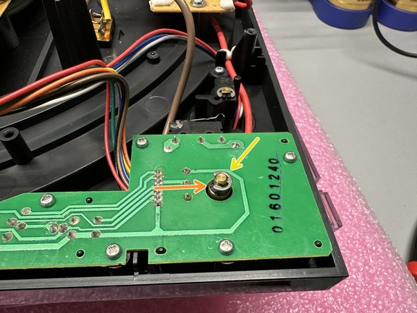

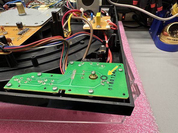

  7. AT-LP120-USB Start/Stop Button Replacement, Replacement: Removing Clamp and Washer: crwdns2935265:07crwdnd2935265:01crwdnd2935265:03crwdne2935265:0 AT-LP120-USB Start/Stop Button Replacement, Replacement: Removing Clamp and Washer: crwdns2935265:07crwdnd2935265:02crwdnd2935265:03crwdne2935265:0 AT-LP120-USB Start/Stop Button Replacement, Replacement: Removing Clamp and Washer: crwdns2935265:07crwdnd2935265:03crwdnd2935265:03crwdne2935265:0
    • Adjust the turntable on top of the dust cover such that the button is protruding from the PCB.
    • Use a pair of tweezers or needle-nose pliers to remove the silver clamp.
    • The clamp requires a bit of force to be pulled off from the post.
    • Remove the black felt washer from the post.
    • Do not dispose of any pieces that come off of the button as these will be used on the replacement button.

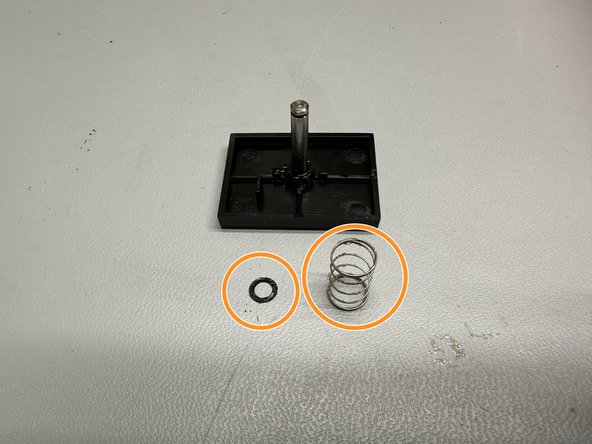

  8. AT-LP120-USB Start/Stop Button Replacement, Replacement: Removing The Button: crwdns2935265:08crwdnd2935265:01crwdnd2935265:03crwdne2935265:0 AT-LP120-USB Start/Stop Button Replacement, Replacement: Removing The Button: crwdns2935265:08crwdnd2935265:02crwdnd2935265:03crwdne2935265:0 AT-LP120-USB Start/Stop Button Replacement, Replacement: Removing The Button: crwdns2935265:08crwdnd2935265:03crwdnd2935265:03crwdne2935265:0
    • The button is now loose and is able to be removed.
    • Adjust the turntable so the dust cover is no longer holding the button up.
    • Remove the button and spring if it did not fall from adjusting the turntable.
    • Remove the spring and black felt washer from the button shaft.
    • If the spring and/or black felt washer are not attached to the button upon removal they are likely stuck near where the button was removed from.

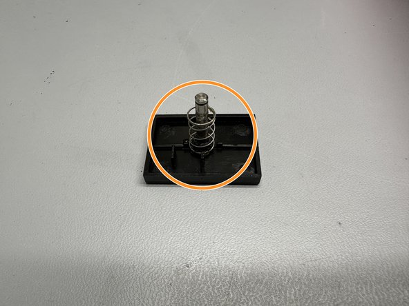

  9. AT-LP120-USB Start/Stop Button Replacement, Replacement: Configuring The New Button: crwdns2935265:09crwdnd2935265:01crwdnd2935265:01crwdne2935265:0
    • Locate your replacement button and place it such that the black plastic post is closest to you.
    • Keeping the button in this orientation for the remainder of the repair will ensure the correct orientation upon completion.
    • Slide the black felt washer down to the base of the shaft.
    • Position the spring around the shaft in-between the small plastic posts.

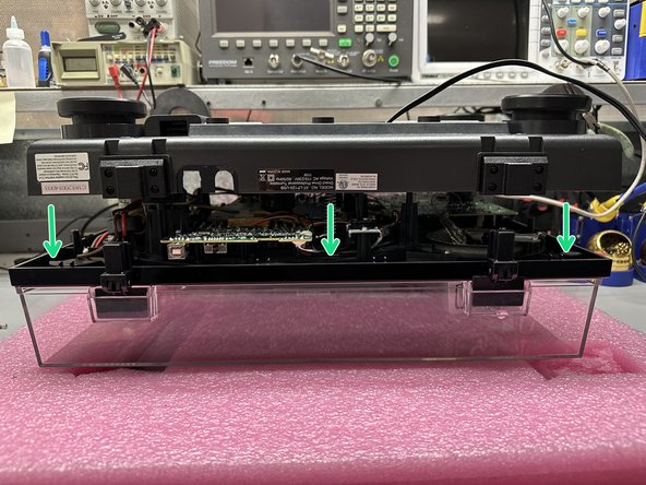

  11. AT-LP120-USB Start/Stop Button Replacement, Reassembly: Placing Bottom Cover: crwdns2935265:011crwdnd2935265:01crwdnd2935265:03crwdne2935265:0 AT-LP120-USB Start/Stop Button Replacement, Reassembly: Placing Bottom Cover: crwdns2935265:011crwdnd2935265:02crwdnd2935265:03crwdne2935265:0 AT-LP120-USB Start/Stop Button Replacement, Reassembly: Placing Bottom Cover: crwdns2935265:011crwdnd2935265:03crwdnd2935265:03crwdne2935265:0

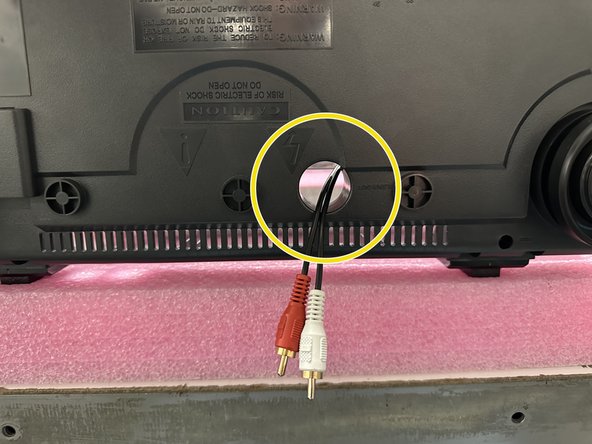

    • Spin the turntable back around such that the rear is facing you.
    • Place the hinges back into the dust cover.
    • Press this part of the hinge so the hinge is in a vertical position.
    • Locate the bottom cover, and route the RCA cables com from the turntable through this hole.
    • Place the bottom cover onto the turntable such that the dust cover hinges are inserted into their respective brackets, and all ports are visible.
    • Depending on manufacturer date, you may need to tilt the bottom cover and insert the ports/switches before re-attaching the hinges and dust cover.

    • Insert the 8 screws with the brass bushings attached into the bottom cover.
    • Brass bushing placement on the screw is shown in Step 6
