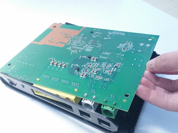

  4. AT&T NVG510 Button Replacement: crwdns2935265:04crwdnd2935265:01crwdnd2935265:02crwdne2935265:0 AT&T NVG510 Button Replacement: crwdns2935265:04crwdnd2935265:02crwdnd2935265:02crwdne2935265:0
    • Lift the board slowly out of the case.
    • Be careful as to not damage the board.

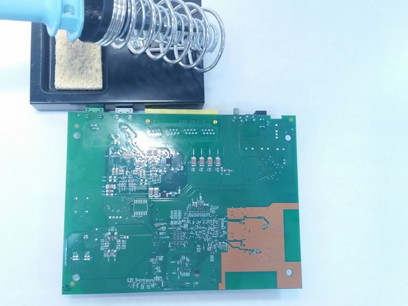

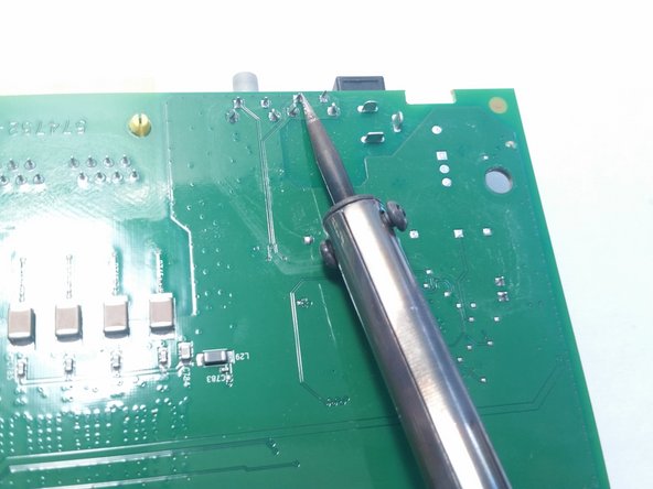

    • Locate the silver points that connect the buttons to the board.
    • To release the buttons, use a soldering iron to heat up and melt the silver connecting points.
    • Avoid touching the solder to the board. Touch only the silver points.
