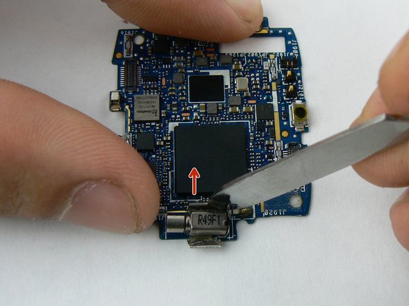

    1. ASUS ZenWatch Vibration motor Replacement, Vibration motor: crwdns2935265:010crwdnd2935265:01crwdnd2935265:03crwdne2935265:0 ASUS ZenWatch Vibration motor Replacement, Vibration motor: crwdns2935265:010crwdnd2935265:02crwdnd2935265:03crwdne2935265:0 ASUS ZenWatch Vibration motor Replacement, Vibration motor: crwdns2935265:010crwdnd2935265:03crwdnd2935265:03crwdne2935265:0
      • With a flat metal spudger pry back the little metal clamps that hold the motor secure.
      • Do not bend these too far as they can easily break off!

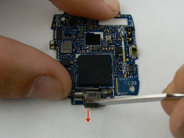

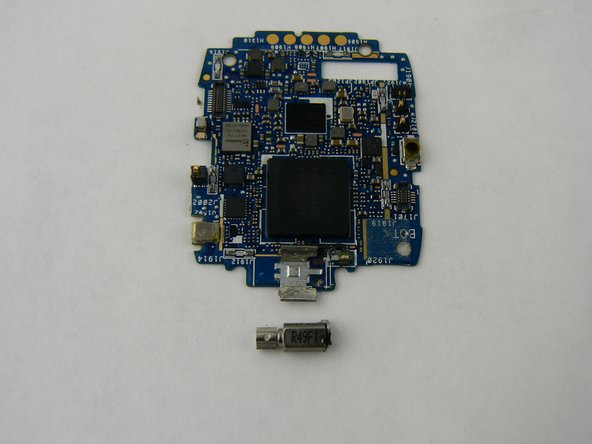

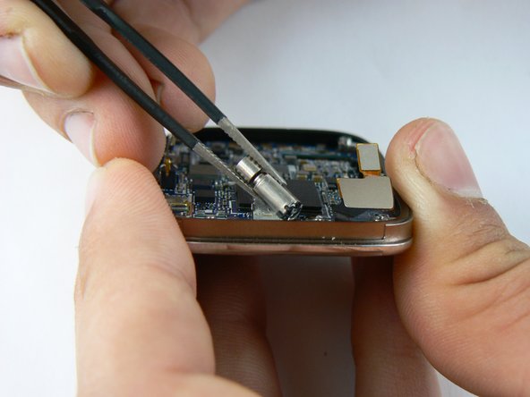

    2. ASUS ZenWatch Vibration motor Replacement: crwdns2935265:011crwdnd2935265:01crwdnd2935265:03crwdne2935265:0 ASUS ZenWatch Vibration motor Replacement: crwdns2935265:011crwdnd2935265:02crwdnd2935265:03crwdne2935265:0 ASUS ZenWatch Vibration motor Replacement: crwdns2935265:011crwdnd2935265:03crwdnd2935265:03crwdne2935265:0
      • With the soldering iron, heat the two solder tabs on back of motor.
      • Use metal tweezers to pull up and remove motor.
      • A soldering iron gets hot! Take care not to burn yourself or place it on any other part of the board.
