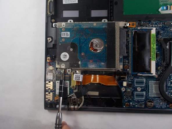

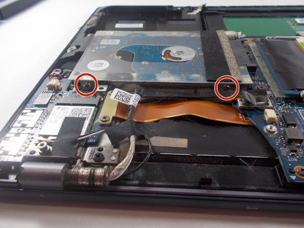

  7. ASUS ZenBook UX302LA-BHI5T08 Hard Drive Replacement, Hard Drive: crwdns2935265:07crwdnd2935265:01crwdnd2935265:03crwdne2935265:0 ASUS ZenBook UX302LA-BHI5T08 Hard Drive Replacement, Hard Drive: crwdns2935265:07crwdnd2935265:02crwdnd2935265:03crwdne2935265:0 ASUS ZenBook UX302LA-BHI5T08 Hard Drive Replacement, Hard Drive: crwdns2935265:07crwdnd2935265:03crwdnd2935265:03crwdne2935265:0
    • Remove four 3 mm Phillips screws (two on each side) holding the hard drive in the frame

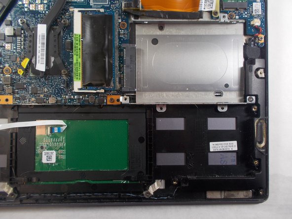

  8. ASUS ZenBook UX302LA-BHI5T08 Hard Drive Replacement: crwdns2935265:08crwdnd2935265:01crwdnd2935265:02crwdne2935265:0 ASUS ZenBook UX302LA-BHI5T08 Hard Drive Replacement: crwdns2935265:08crwdnd2935265:02crwdnd2935265:02crwdne2935265:0
    • Grip the side of the hard drive and slide it out of the device.
