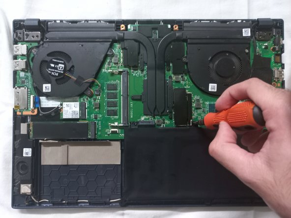

    • Make sure that you have unplugged your laptop and powered it off before beginning the repair.
    • Flip the laptop over so the bottom is facing up.
    • Use a spudger to gently pry off the two screw covers just below each hinge.
    • Don't rip them when removing, as you will need them for reassembly.

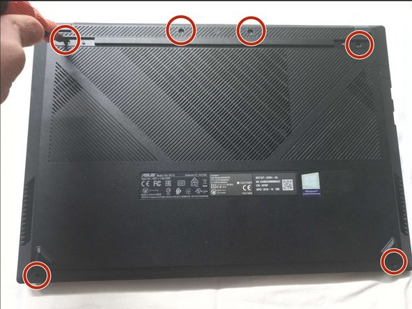

    • Use a Phillips #00 screwdriver to remove the six 5 mm screws on the back case of the laptop.

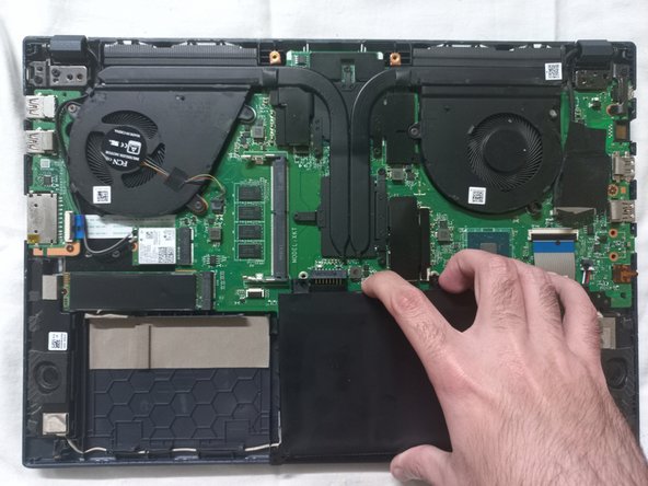

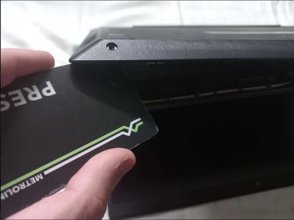

    • Insert an opening tool or plastic card into the thin seam between the back case and the device.
    • Slide the plastic tool around the perimeter of the laptop to release the clips/connectors.
    • Do not pull the back case off without releasing the clips first, as they can break off.
    • Use a piece of tape to help you lift up the back panel initially, so that you can easily insert your plastic tool.
    • Remove the back case to reveal the internals of the laptop.

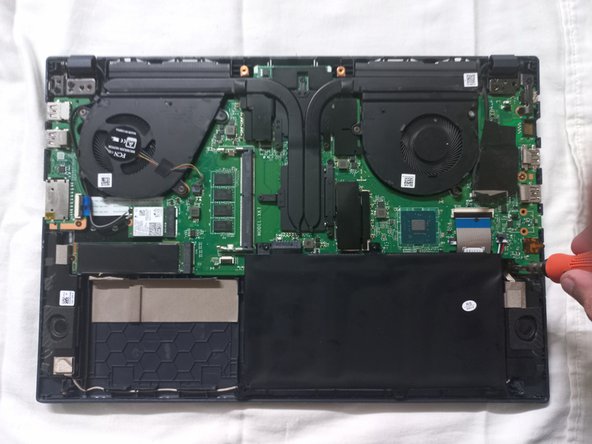

  4. ASUS X571GT Battery Replacement: crwdns2935265:04crwdnd2935265:01crwdnd2935265:03crwdne2935265:0 ASUS X571GT Battery Replacement: crwdns2935265:04crwdnd2935265:02crwdnd2935265:03crwdne2935265:0 ASUS X571GT Battery Replacement: crwdns2935265:04crwdnd2935265:03crwdnd2935265:03crwdne2935265:0

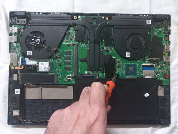

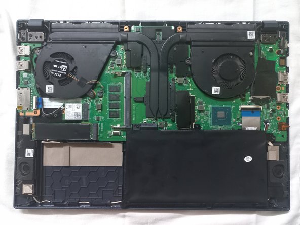

    • Use a Phillips #00 screwdriver to remove the three 5 mm screws securing the battery.
    • Be cautious when handling the battery, if the battery appears swollen or is damaged consult this guide.

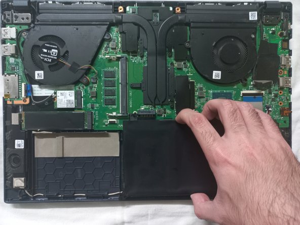

  5. ASUS X571GT Battery Replacement: crwdns2935265:05crwdnd2935265:01crwdnd2935265:03crwdne2935265:0 ASUS X571GT Battery Replacement: crwdns2935265:05crwdnd2935265:02crwdnd2935265:03crwdne2935265:0 ASUS X571GT Battery Replacement: crwdns2935265:05crwdnd2935265:03crwdnd2935265:03crwdne2935265:0

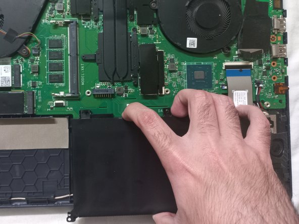

    • Slide the battery out of the connector to disconnect it from the motherboard.
    • Make sure you do not damage any connector pins or the battery. Do not bend the battery while removing it from the laptop.

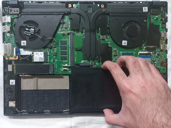

    • Line up the new replacement battery with the connector pins, and slide it into place.
    • Make sure that you have lined up the pins correctly. Once again, do not bend the battery in any way.
    • Carefully connect the battery to the socket on the motherboard to prevent bending or damaging the pins.

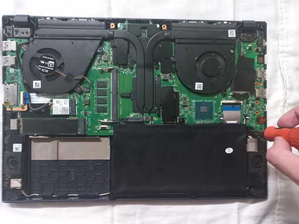

  7. ASUS X571GT Battery Replacement: crwdns2935265:07crwdnd2935265:01crwdnd2935265:03crwdne2935265:0 ASUS X571GT Battery Replacement: crwdns2935265:07crwdnd2935265:02crwdnd2935265:03crwdne2935265:0 ASUS X571GT Battery Replacement: crwdns2935265:07crwdnd2935265:03crwdnd2935265:03crwdne2935265:0
    • Use a Phillips #00 screwdriver to replace the three 5 mm screws that secure the battery.
    • Do not overtighten the screws to avoid stripping them in the future.

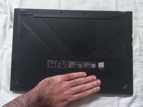

    • Replace the back cover.
    • When reattaching the back panel make sure to gently press it in on all edges until you here it click into place.
    • Use a Phillips #00 screwdriver to secure the six 5 mm screws on the back case.
