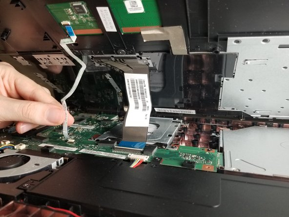

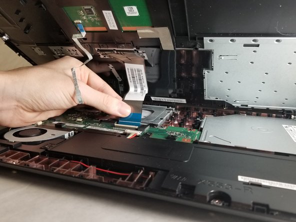

  4. ASUS X553SA-BHCLN10 Keyboard Replacement: crwdns2935265:04crwdnd2935265:01crwdnd2935265:03crwdne2935265:0 ASUS X553SA-BHCLN10 Keyboard Replacement: crwdns2935265:04crwdnd2935265:02crwdnd2935265:03crwdne2935265:0 ASUS X553SA-BHCLN10 Keyboard Replacement: crwdns2935265:04crwdnd2935265:03crwdnd2935265:03crwdne2935265:0
    • After prying open all sides of the laptop, carefully remove the keyboard from the laptop.
    • Carefully remove the two cables connecting the keyboard to the laptop by popping up the white clips and sliding the connector out.
