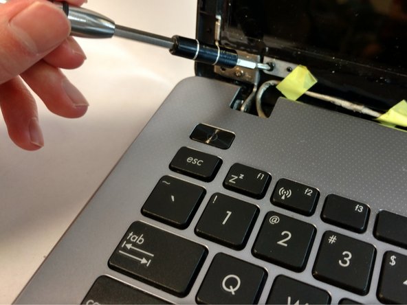

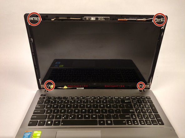

    3. ASUS X550LB-DS71 Display Panel Replacement: crwdns2935265:03crwdnd2935265:01crwdnd2935265:03crwdne2935265:0 ASUS X550LB-DS71 Display Panel Replacement: crwdns2935265:03crwdnd2935265:02crwdnd2935265:03crwdne2935265:0 ASUS X550LB-DS71 Display Panel Replacement: crwdns2935265:03crwdnd2935265:03crwdnd2935265:03crwdne2935265:0
      • Peel off the tape located on the left and right side of the display monitor.
      • Use the Phillips #0 screwdriver to remove the screws at the marked locations in each corner of the display.
