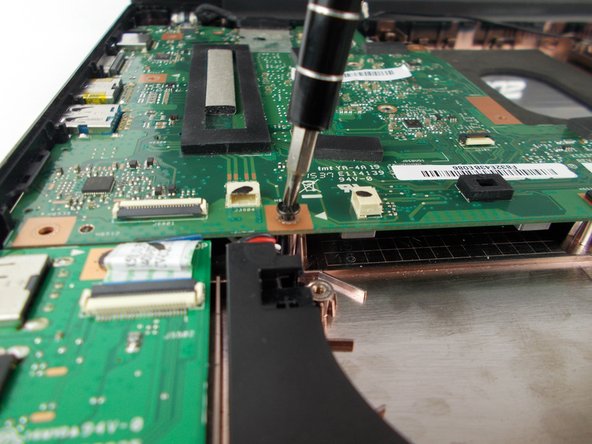

    • Remove the Phillips #0 screws securing the motherboard to laptop.

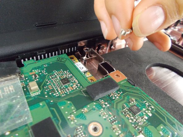

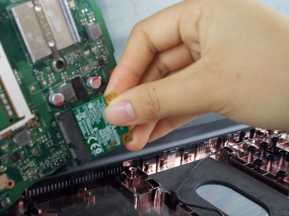

    • Remove the Wi-Fi card from the motherboard.
