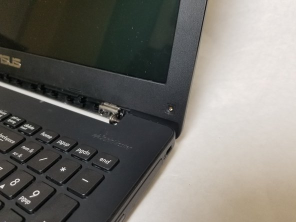

    • Power off laptop.
    • Flip over the laptop so the model stickers are pointing towards the ceiling, and the back of the laptop is facing you.

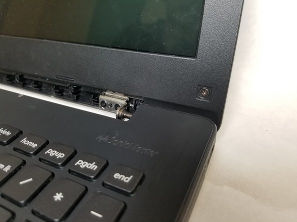

  2. ASUS X533SA-BHCLN10 LCD Screen Replacement: crwdns2935265:02crwdnd2935265:01crwdnd2935265:03crwdne2935265:0 ASUS X533SA-BHCLN10 LCD Screen Replacement: crwdns2935265:02crwdnd2935265:02crwdnd2935265:03crwdne2935265:0 ASUS X533SA-BHCLN10 LCD Screen Replacement: crwdns2935265:02crwdnd2935265:03crwdnd2935265:03crwdne2935265:0
    • Carefully insert a plastic opening tool into the top edge of the plastic cover. Slowly run the tool along the top edge to allow several small plastic clips to release.
    • Lift the plastic cover off and set it aside.

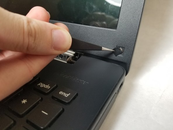

  3. ASUS X533SA-BHCLN10 LCD Screen Replacement: crwdns2935265:03crwdnd2935265:01crwdnd2935265:03crwdne2935265:0 ASUS X533SA-BHCLN10 LCD Screen Replacement: crwdns2935265:03crwdnd2935265:02crwdnd2935265:03crwdne2935265:0 ASUS X533SA-BHCLN10 LCD Screen Replacement: crwdns2935265:03crwdnd2935265:03crwdnd2935265:03crwdne2935265:0
    • Using tweezers, remove the (2) two magnetic tabs covering the screws on the screen.

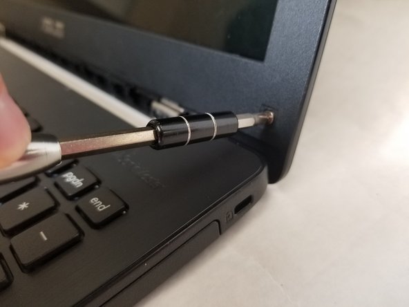

  4. ASUS X533SA-BHCLN10 LCD Screen Replacement: crwdns2935265:04crwdnd2935265:01crwdnd2935265:03crwdne2935265:0 ASUS X533SA-BHCLN10 LCD Screen Replacement: crwdns2935265:04crwdnd2935265:02crwdnd2935265:03crwdne2935265:0 ASUS X533SA-BHCLN10 LCD Screen Replacement: crwdns2935265:04crwdnd2935265:03crwdnd2935265:03crwdne2935265:0
    • Use a JIS #0 screwdriver to remove the two 4.5mm screws.

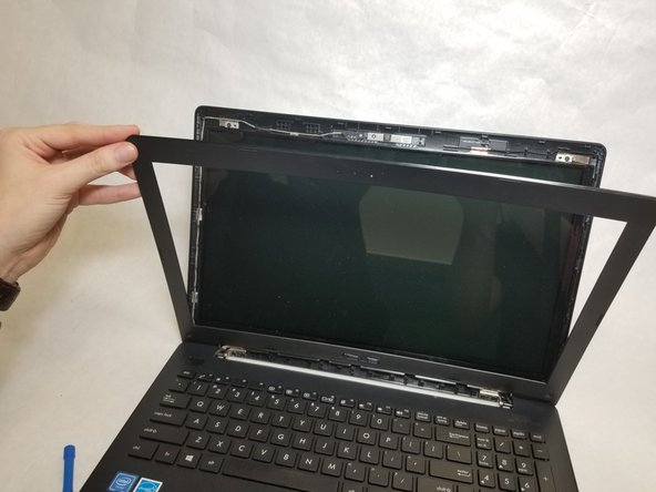

  5. ASUS X533SA-BHCLN10 LCD Screen Replacement: crwdns2935265:05crwdnd2935265:01crwdnd2935265:02crwdne2935265:0 ASUS X533SA-BHCLN10 LCD Screen Replacement: crwdns2935265:05crwdnd2935265:02crwdnd2935265:02crwdne2935265:0
    • Insert a plastic opening tool under the edge of the laptop lid.
    • Carefully pop out the sides of the laptop by running the plastic opening tool along the edge.

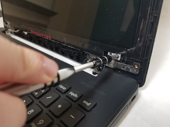

  6. ASUS X533SA-BHCLN10 LCD Screen Replacement: crwdns2935265:06crwdnd2935265:01crwdnd2935265:02crwdne2935265:0 ASUS X533SA-BHCLN10 LCD Screen Replacement: crwdns2935265:06crwdnd2935265:02crwdnd2935265:02crwdne2935265:0
    • Use a JIS #0 screwdriver to unscrew the four 3.5mm screws.

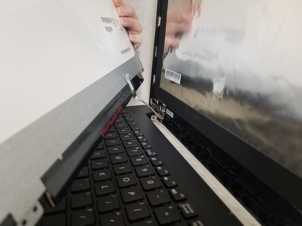

  7. ASUS X533SA-BHCLN10 LCD Screen Replacement: crwdns2935265:07crwdnd2935265:01crwdnd2935265:03crwdne2935265:0 ASUS X533SA-BHCLN10 LCD Screen Replacement: crwdns2935265:07crwdnd2935265:02crwdnd2935265:03crwdne2935265:0 ASUS X533SA-BHCLN10 LCD Screen Replacement: crwdns2935265:07crwdnd2935265:03crwdnd2935265:03crwdne2935265:0
    • Carefully lift up the LCD screen.

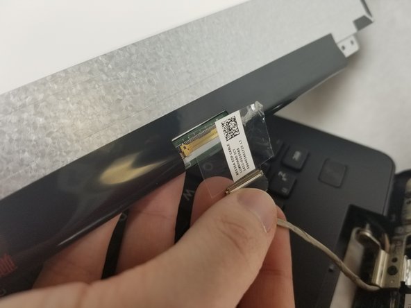

    • Carefully remove the cable connecting the LCD to the laptop by popping up the white clip on the laptop and sliding the connector out.
