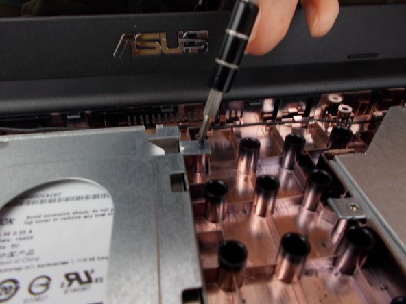

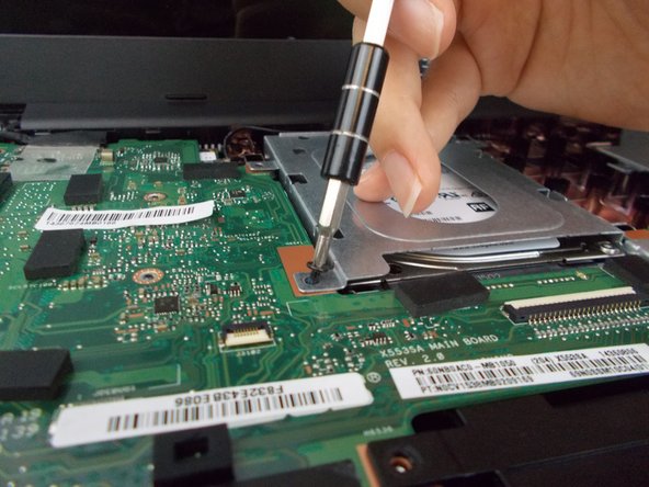

  4. ASUS X533SA-BHCLN10 Hard Drive Replacement, Hard Drive: crwdns2935265:04crwdnd2935265:01crwdnd2935265:03crwdne2935265:0 ASUS X533SA-BHCLN10 Hard Drive Replacement, Hard Drive: crwdns2935265:04crwdnd2935265:02crwdnd2935265:03crwdne2935265:0 ASUS X533SA-BHCLN10 Hard Drive Replacement, Hard Drive: crwdns2935265:04crwdnd2935265:03crwdnd2935265:03crwdne2935265:0
    • The hard drive is closest to the screen, enclosed in a metal plate.
    • Remove all screws holding the hard drive in place.
  5. ASUS X533SA-BHCLN10 Hard Drive Replacement: crwdns2935265:05crwdnd2935265:01crwdnd2935265:01crwdne2935265:0
    • After all screws are removed, carefully disconnect the hard drive and slide it out.
  6. ASUS X533SA-BHCLN10 Hard Drive Replacement: crwdns2935265:06crwdnd2935265:01crwdnd2935265:01crwdne2935265:0
    • Remove screws from the metal plate enclosing hard drive and enclose replacement hard drive in metal plate.
