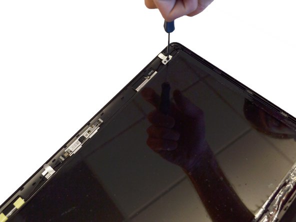

    3. ASUS X502CA Screen Replacement: crwdns2935265:03crwdnd2935265:01crwdnd2935265:02crwdne2935265:0 ASUS X502CA Screen Replacement: crwdns2935265:03crwdnd2935265:02crwdnd2935265:02crwdne2935265:0
      • Remove the four phillips screws (two on top and two on bottom) using the Phillips #00 screwdriver.
      • The screws are black, 45mm long and 15mm in diameter with a philips head

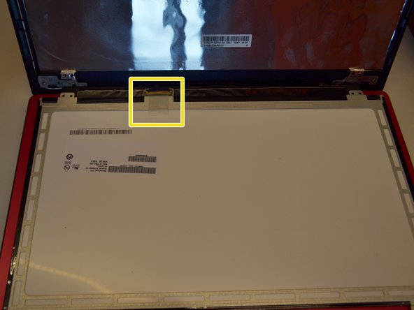

    5. ASUS X502CA Screen Replacement: crwdns2935265:05crwdnd2935265:01crwdnd2935265:02crwdne2935265:0 ASUS X502CA Screen Replacement: crwdns2935265:05crwdnd2935265:02crwdnd2935265:02crwdne2935265:0
      • Peel off the clear tape that is securing the video cable connector using your fingers or tweezers.
    6. ASUS X502CA Screen Replacement: crwdns2935265:06crwdnd2935265:01crwdnd2935265:02crwdne2935265:0 ASUS X502CA Screen Replacement: crwdns2935265:06crwdnd2935265:02crwdnd2935265:02crwdne2935265:0
      • Unplug the screen using tweezers.
