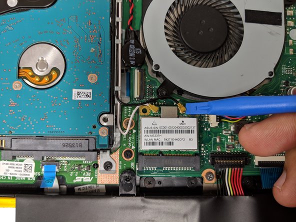

  3. ASUS Vivobook Q301LA-BSI5T17 WIFI CHIP Replacement, WIFI CHIP: crwdns2935265:03crwdnd2935265:01crwdnd2935265:03crwdne2935265:0 ASUS Vivobook Q301LA-BSI5T17 WIFI CHIP Replacement, WIFI CHIP: crwdns2935265:03crwdnd2935265:02crwdnd2935265:03crwdne2935265:0 ASUS Vivobook Q301LA-BSI5T17 WIFI CHIP Replacement, WIFI CHIP: crwdns2935265:03crwdnd2935265:03crwdnd2935265:03crwdne2935265:0
    • Locate the wifi module on the back of your laptop.
    • Use an iFixit opening tool to pry the black (Main) and the white (Aux) coaxial cable connectors upward.
  4. ASUS Vivobook Q301LA-BSI5T17 WIFI CHIP Replacement: crwdns2935265:04crwdnd2935265:01crwdnd2935265:01crwdne2935265:0
    • Remove the 5mm screw from the module using the Phillips PH1 screwdriver.
  5. ASUS Vivobook Q301LA-BSI5T17 WIFI CHIP Replacement: crwdns2935265:05crwdnd2935265:01crwdnd2935265:01crwdne2935265:0
    • Gently pull the WiFi module out of its housing from the motherboard.
    • Careful not to break or bend the metal contacts.
