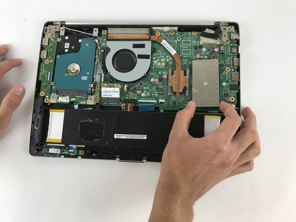

    • Unscrew the (10) screws on the bottom of the computer chassis using the JIS #0 screwdriver.
  2. ASUS Vivobook Q301LA-BSI5T17 RAM Replacement: crwdns2935265:02crwdnd2935265:01crwdnd2935265:02crwdne2935265:0 ASUS Vivobook Q301LA-BSI5T17 RAM Replacement: crwdns2935265:02crwdnd2935265:02crwdnd2935265:02crwdne2935265:0
    • Slightly lift the lower case and push it toward the rear of the computer to free the mounting tabs.
  3. ASUS Vivobook Q301LA-BSI5T17 RAM Replacement: crwdns2935265:03crwdnd2935265:01crwdnd2935265:03crwdne2935265:0 ASUS Vivobook Q301LA-BSI5T17 RAM Replacement: crwdns2935265:03crwdnd2935265:02crwdnd2935265:03crwdne2935265:0 ASUS Vivobook Q301LA-BSI5T17 RAM Replacement: crwdns2935265:03crwdnd2935265:03crwdnd2935265:03crwdne2935265:0
    • Remove the (6) six screws attaching the battery to the frame using the JIS #0 screwdriver.
    • Use the black plastic spudger to remove the battery from the device.
  4. ASUS Vivobook Q301LA-BSI5T17 RAM Replacement: crwdns2935265:04crwdnd2935265:01crwdnd2935265:03crwdne2935265:0 ASUS Vivobook Q301LA-BSI5T17 RAM Replacement: crwdns2935265:04crwdnd2935265:02crwdnd2935265:03crwdne2935265:0 ASUS Vivobook Q301LA-BSI5T17 RAM Replacement: crwdns2935265:04crwdnd2935265:03crwdnd2935265:03crwdne2935265:0
    • Gently take the battery out of the laptop, making sure that all wires connecting to it are disconnected.
  5. ASUS Vivobook Q301LA-BSI5T17 RAM Replacement, RAM: crwdns2935265:05crwdnd2935265:01crwdnd2935265:02crwdne2935265:0 ASUS Vivobook Q301LA-BSI5T17 RAM Replacement, RAM: crwdns2935265:05crwdnd2935265:02crwdnd2935265:02crwdne2935265:0
    • Gently pry this metal cover off the motherboard.
  6. ASUS Vivobook Q301LA-BSI5T17 RAM Replacement: crwdns2935265:06crwdnd2935265:01crwdnd2935265:03crwdne2935265:0 ASUS Vivobook Q301LA-BSI5T17 RAM Replacement: crwdns2935265:06crwdnd2935265:02crwdnd2935265:03crwdne2935265:0 ASUS Vivobook Q301LA-BSI5T17 RAM Replacement: crwdns2935265:06crwdnd2935265:03crwdnd2935265:03crwdne2935265:0
    • Now the RAM stick is exposed. Using two fingers, gently push the buttons to release the RAM stick
  7. ASUS Vivobook Q301LA-BSI5T17 RAM Replacement: crwdns2935265:07crwdnd2935265:01crwdnd2935265:01crwdne2935265:0
    • When you put in the new RAM, make sure to line up the connectors. Put the RAM in gently, as being rough with it can cause damage to the stick.
