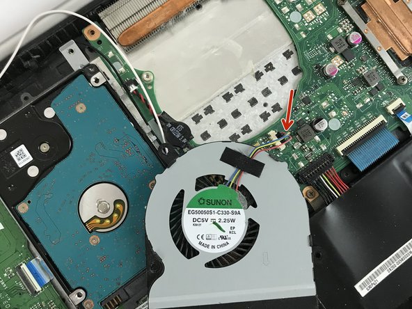

  5. ASUS Vivobook Q301LA-BSI5T17 Motherboard Replacement, Motherboard: crwdns2935265:05crwdnd2935265:01crwdnd2935265:02crwdne2935265:0 ASUS Vivobook Q301LA-BSI5T17 Motherboard Replacement, Motherboard: crwdns2935265:05crwdnd2935265:02crwdnd2935265:02crwdne2935265:0
    • When removing the cooling fan, carefully unplug the cable that is connected to the motherboard.
    • Once you have carefully unplugged the cable, the cooling fan should just come off with ease.

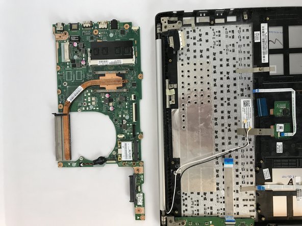

  6. ASUS Vivobook Q301LA-BSI5T17 Motherboard Replacement: crwdns2935265:06crwdnd2935265:01crwdnd2935265:02crwdne2935265:0 ASUS Vivobook Q301LA-BSI5T17 Motherboard Replacement: crwdns2935265:06crwdnd2935265:02crwdnd2935265:02crwdne2935265:0
    • Carefully remove the motherboard.
    • You can now replace it with a new motherboard or perform any necessary modifications to it.
