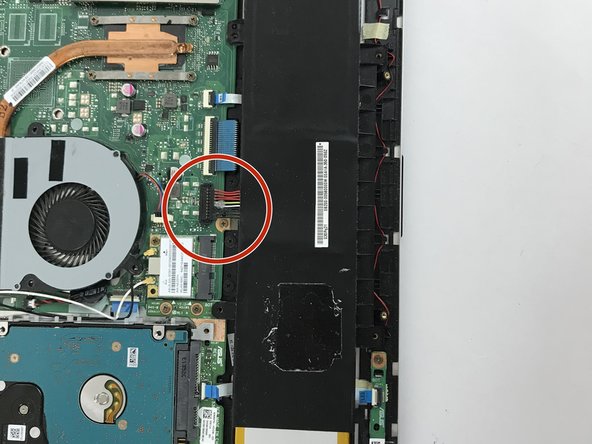

    • Remove the (6) six screws attaching the battery to the frame using the JIS #0 screwdriver.
    • Use the black plastic spudger to remove the battery from the device.
  4. ASUS Vivobook Q301LA-BSI5T17 Hard Drive Replacement: crwdns2935265:04crwdnd2935265:01crwdnd2935265:03crwdne2935265:0 ASUS Vivobook Q301LA-BSI5T17 Hard Drive Replacement: crwdns2935265:04crwdnd2935265:02crwdnd2935265:03crwdne2935265:0 ASUS Vivobook Q301LA-BSI5T17 Hard Drive Replacement: crwdns2935265:04crwdnd2935265:03crwdnd2935265:03crwdne2935265:0
    • Gently take the battery out of the laptop, making sure that all wires connecting to it are disconnected.
