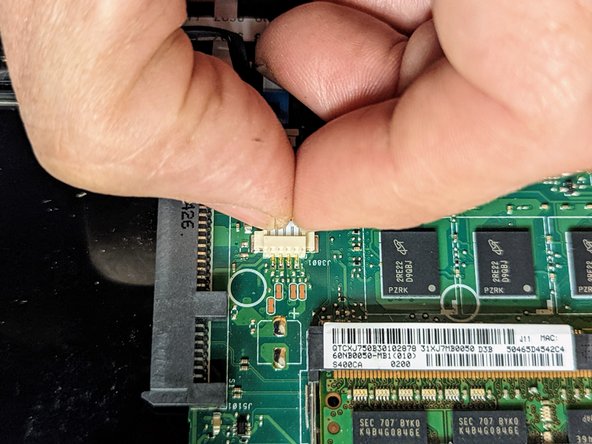

  3. ASUS VivoBook S400C Motherboard Replacement, Disconnect the Battery: crwdns2935265:03crwdnd2935265:01crwdnd2935265:01crwdne2935265:0
    • Using a spudger, lift up the plug connecting the battery to the motherboard.

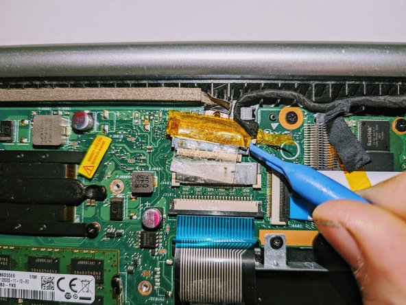

  8. ASUS VivoBook S400C Motherboard Replacement, Heat Shield: crwdns2935265:08crwdnd2935265:01crwdnd2935265:02crwdne2935265:0 ASUS VivoBook S400C Motherboard Replacement, Heat Shield: crwdns2935265:08crwdnd2935265:02crwdnd2935265:02crwdne2935265:0
    • Remove the black shield covering the display connector and the heat sink.
    • You may need to use double-sided adhesive tape to resecure the shield.

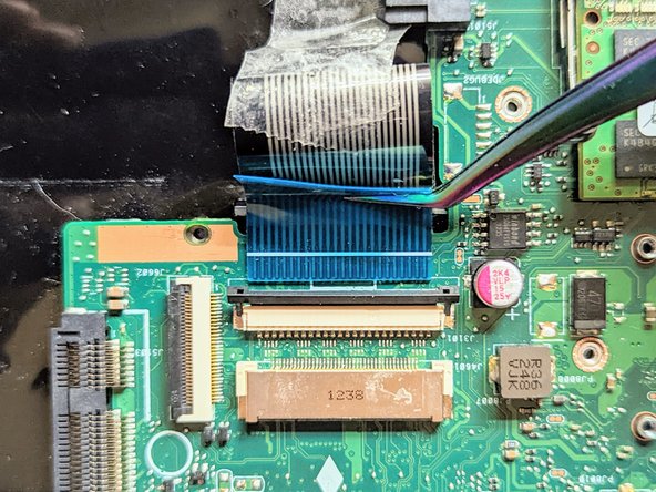

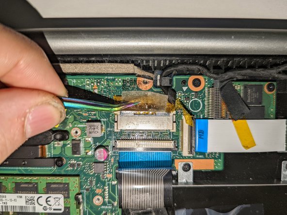

  10. ASUS VivoBook S400C Motherboard Replacement: crwdns2935265:010crwdnd2935265:01crwdnd2935265:02crwdne2935265:0 ASUS VivoBook S400C Motherboard Replacement: crwdns2935265:010crwdnd2935265:02crwdnd2935265:02crwdne2935265:0
    • Peel off the clear tape from the motherboard display connector.

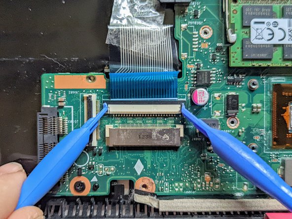

  11. ASUS VivoBook S400C Motherboard Replacement: crwdns2935265:011crwdnd2935265:01crwdnd2935265:02crwdne2935265:0 ASUS VivoBook S400C Motherboard Replacement: crwdns2935265:011crwdnd2935265:02crwdnd2935265:02crwdne2935265:0
    • Position spudgers on the white tabs on either side of the connector and push evenly to unplug the display.

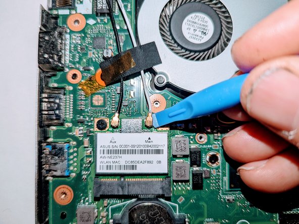

  13. ASUS VivoBook S400C Motherboard Replacement: crwdns2935265:013crwdnd2935265:01crwdnd2935265:03crwdne2935265:0 ASUS VivoBook S400C Motherboard Replacement: crwdns2935265:013crwdnd2935265:02crwdnd2935265:03crwdne2935265:0 ASUS VivoBook S400C Motherboard Replacement: crwdns2935265:013crwdnd2935265:03crwdnd2935265:03crwdne2935265:0
    • Use a spudger to release the cables from the wifi card.

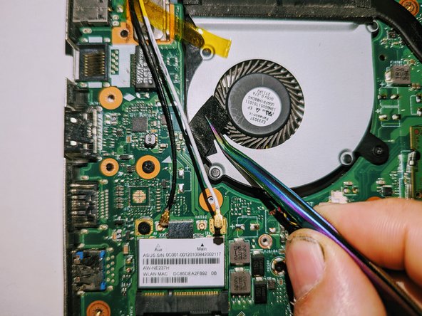

  14. ASUS VivoBook S400C Motherboard Replacement: crwdns2935265:014crwdnd2935265:01crwdnd2935265:03crwdne2935265:0 ASUS VivoBook S400C Motherboard Replacement: crwdns2935265:014crwdnd2935265:02crwdnd2935265:03crwdne2935265:0 ASUS VivoBook S400C Motherboard Replacement: crwdns2935265:014crwdnd2935265:03crwdnd2935265:03crwdne2935265:0
    • Lift the tapes securing the wires to the motherboard.
    • Move the wires to the side out of the way.

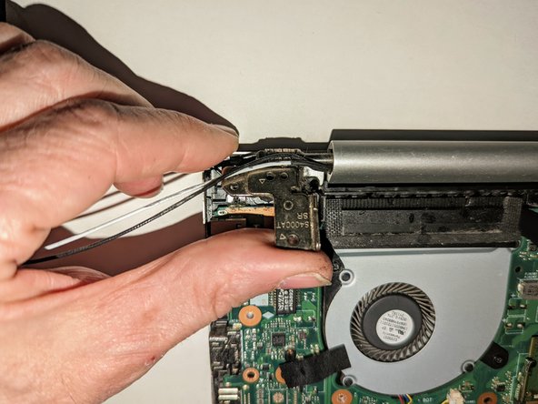

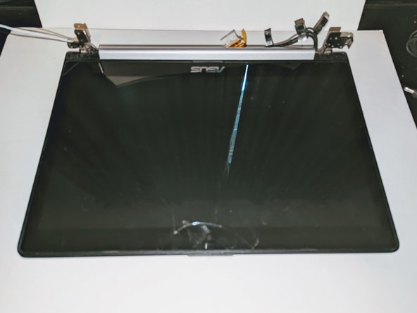

  15. ASUS VivoBook S400C Motherboard Replacement, Disconnect the Hinges: crwdns2935265:015crwdnd2935265:01crwdnd2935265:02crwdne2935265:0 ASUS VivoBook S400C Motherboard Replacement, Disconnect the Hinges: crwdns2935265:015crwdnd2935265:02crwdnd2935265:02crwdne2935265:0
    • Remove the two screws securing the hinge on the left.
    • Pry the hinge up by hand to a 90 degree angle.
  16. ASUS VivoBook S400C Motherboard Replacement: crwdns2935265:016crwdnd2935265:01crwdnd2935265:02crwdne2935265:0 ASUS VivoBook S400C Motherboard Replacement: crwdns2935265:016crwdnd2935265:02crwdnd2935265:02crwdne2935265:0
    • Remove the two screws securing the hinge on the right.

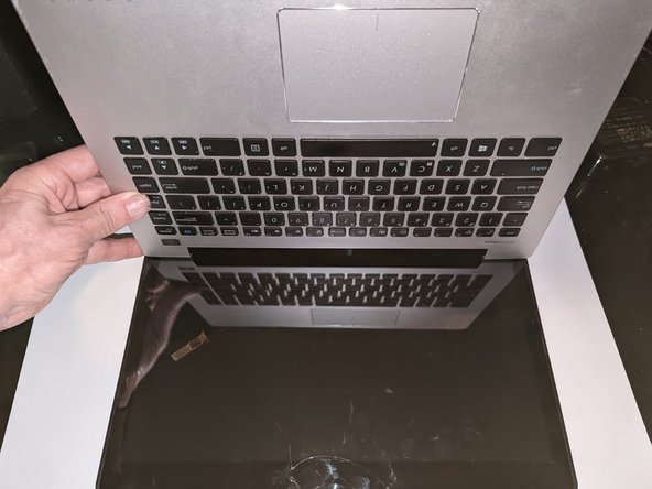

  17. ASUS VivoBook S400C Motherboard Replacement, Remove the Display: crwdns2935265:017crwdnd2935265:01crwdnd2935265:03crwdne2935265:0 ASUS VivoBook S400C Motherboard Replacement, Remove the Display: crwdns2935265:017crwdnd2935265:02crwdnd2935265:03crwdne2935265:0 ASUS VivoBook S400C Motherboard Replacement, Remove the Display: crwdns2935265:017crwdnd2935265:03crwdnd2935265:03crwdne2935265:0
    • Lift the base of the laptop from the front.
    • Raise it to a 90 degree angle.
    • Slide it forward slightly to clear the hinges.
    • The display is now free.

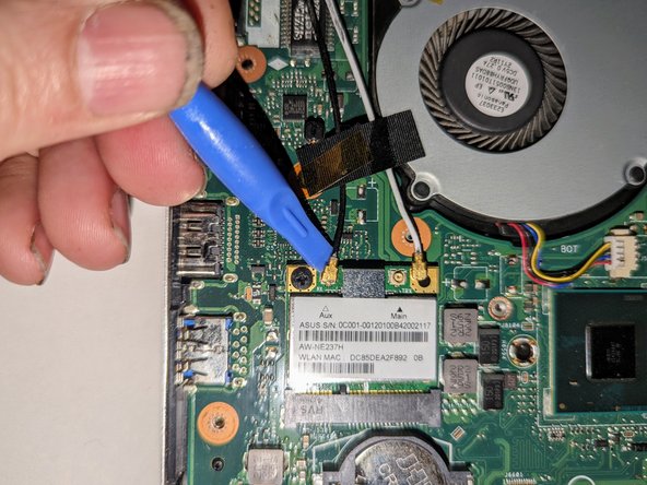

  18. ASUS VivoBook S400C Motherboard Replacement, Wifi Card: crwdns2935265:018crwdnd2935265:01crwdnd2935265:02crwdne2935265:0 ASUS VivoBook S400C Motherboard Replacement, Wifi Card: crwdns2935265:018crwdnd2935265:02crwdnd2935265:02crwdne2935265:0

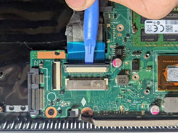

  23. ASUS VivoBook S400C Motherboard Replacement, SSD Card: crwdns2935265:023crwdnd2935265:01crwdnd2935265:03crwdne2935265:0 ASUS VivoBook S400C Motherboard Replacement, SSD Card: crwdns2935265:023crwdnd2935265:02crwdnd2935265:03crwdne2935265:0 ASUS VivoBook S400C Motherboard Replacement, SSD Card: crwdns2935265:023crwdnd2935265:03crwdnd2935265:03crwdne2935265:0

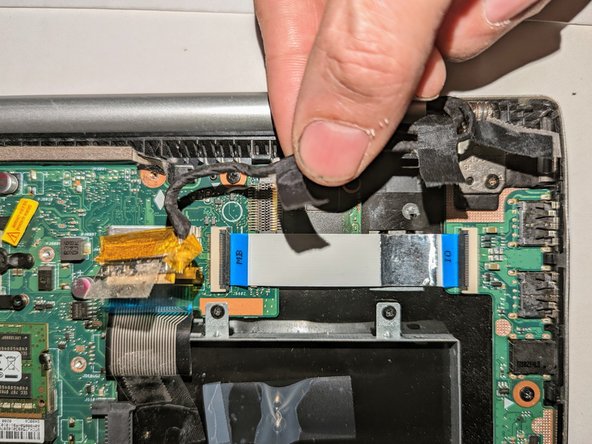

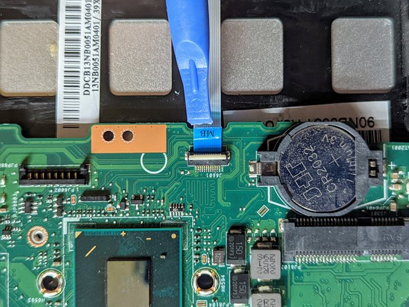

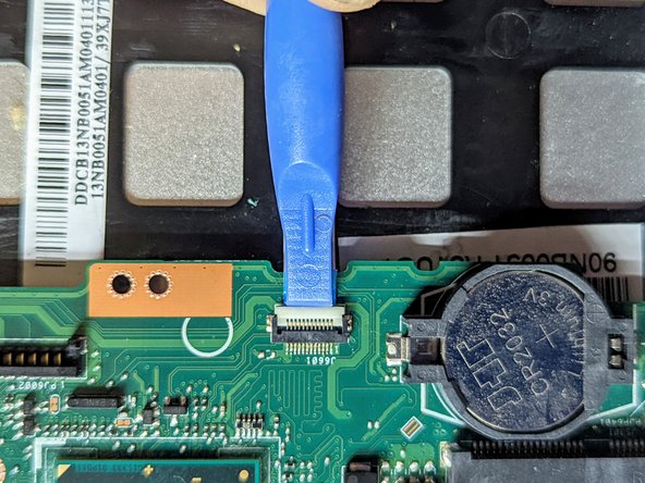

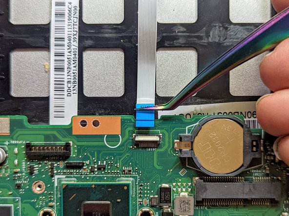

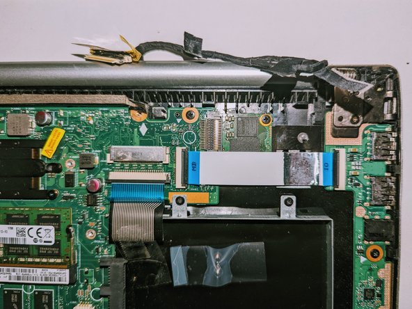

    • Disconnect the I/O Board ribbon cable from the motherboard.
    • Flip up the retaining latch with a spudger.
  24. ASUS VivoBook S400C Motherboard Replacement: crwdns2935265:024crwdnd2935265:01crwdnd2935265:02crwdne2935265:0 ASUS VivoBook S400C Motherboard Replacement: crwdns2935265:024crwdnd2935265:02crwdnd2935265:02crwdne2935265:0
    • Grasp the ribbon cable by the blue tab and pull it straight out from the connector.

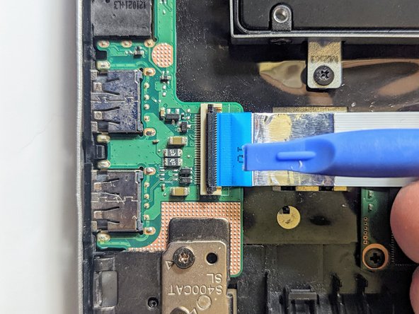

  25. ASUS VivoBook S400C Motherboard Replacement: crwdns2935265:025crwdnd2935265:01crwdnd2935265:03crwdne2935265:0 ASUS VivoBook S400C Motherboard Replacement: crwdns2935265:025crwdnd2935265:02crwdnd2935265:03crwdne2935265:0 ASUS VivoBook S400C Motherboard Replacement: crwdns2935265:025crwdnd2935265:03crwdnd2935265:03crwdne2935265:0
    • Disconnect the I/O Board ribbon cable from the I/O board.
    • Flip up the latch with a spudger.
  26. ASUS VivoBook S400C Motherboard Replacement: crwdns2935265:026crwdnd2935265:01crwdnd2935265:03crwdne2935265:0 ASUS VivoBook S400C Motherboard Replacement: crwdns2935265:026crwdnd2935265:02crwdnd2935265:03crwdne2935265:0 ASUS VivoBook S400C Motherboard Replacement: crwdns2935265:026crwdnd2935265:03crwdnd2935265:03crwdne2935265:0
    • Remove the ribbon cable to expose the SSD device.

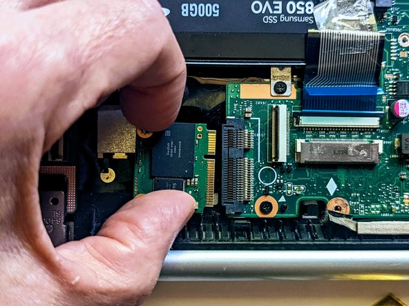

  27. ASUS VivoBook S400C Motherboard Replacement: crwdns2935265:027crwdnd2935265:01crwdnd2935265:01crwdne2935265:0
    • If present, remove any insulating sheet covering the SSD.
    • Remove the single retaining screw.
  28. ASUS VivoBook S400C Motherboard Replacement, Unplug the SSD from the motherboard: crwdns2935265:028crwdnd2935265:01crwdnd2935265:02crwdne2935265:0 ASUS VivoBook S400C Motherboard Replacement, Unplug the SSD from the motherboard: crwdns2935265:028crwdnd2935265:02crwdnd2935265:02crwdne2935265:0
    • Grasp the SSD by the sides and slide it out of the connector.

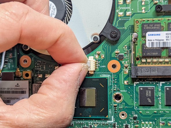

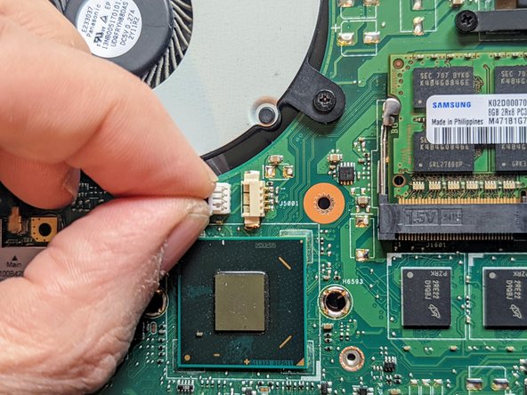

  29. ASUS VivoBook S400C Motherboard Replacement, CPU Fan / Heat Sink Assembly: crwdns2935265:029crwdnd2935265:01crwdnd2935265:03crwdne2935265:0 ASUS VivoBook S400C Motherboard Replacement, CPU Fan / Heat Sink Assembly: crwdns2935265:029crwdnd2935265:02crwdnd2935265:03crwdne2935265:0 ASUS VivoBook S400C Motherboard Replacement, CPU Fan / Heat Sink Assembly: crwdns2935265:029crwdnd2935265:03crwdnd2935265:03crwdne2935265:0
    • Unplug the fan.
    • Grasp the plug with a fingernail on either side and pull it straight out from the connector.

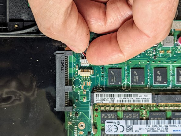

  32. ASUS VivoBook S400C Motherboard Replacement, Motherboard: crwdns2935265:032crwdnd2935265:01crwdnd2935265:03crwdne2935265:0 ASUS VivoBook S400C Motherboard Replacement, Motherboard: crwdns2935265:032crwdnd2935265:02crwdnd2935265:03crwdne2935265:0 ASUS VivoBook S400C Motherboard Replacement, Motherboard: crwdns2935265:032crwdnd2935265:03crwdnd2935265:03crwdne2935265:0
    • Unplug the black cable connecting the motherboard to the speakers.

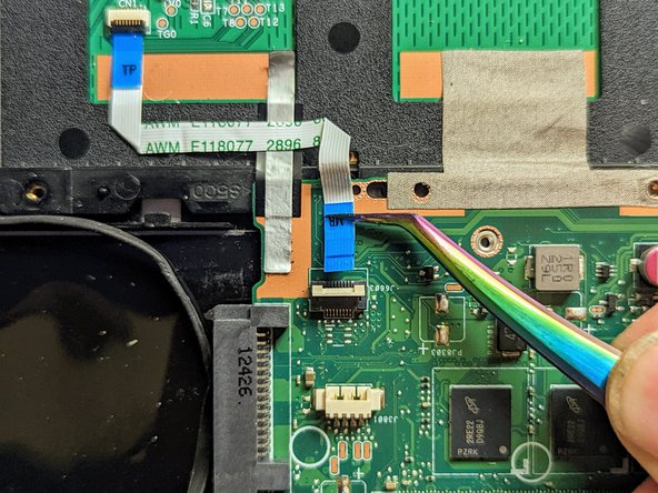

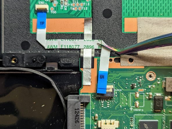

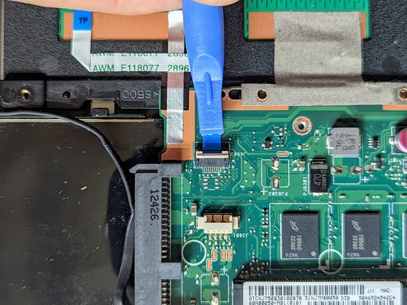

  33. ASUS VivoBook S400C Motherboard Replacement, Disconnect the Trackpad: crwdns2935265:033crwdnd2935265:01crwdnd2935265:03crwdne2935265:0 ASUS VivoBook S400C Motherboard Replacement, Disconnect the Trackpad: crwdns2935265:033crwdnd2935265:02crwdnd2935265:03crwdne2935265:0 ASUS VivoBook S400C Motherboard Replacement, Disconnect the Trackpad: crwdns2935265:033crwdnd2935265:03crwdnd2935265:03crwdne2935265:0
    • Flip up the trackpad ribbon cable retainer with a spudger.
  34. ASUS VivoBook S400C Motherboard Replacement: crwdns2935265:034crwdnd2935265:01crwdnd2935265:03crwdne2935265:0 ASUS VivoBook S400C Motherboard Replacement: crwdns2935265:034crwdnd2935265:02crwdnd2935265:03crwdne2935265:0 ASUS VivoBook S400C Motherboard Replacement: crwdns2935265:034crwdnd2935265:03crwdnd2935265:03crwdne2935265:0
    • Pull the cable straight out from the connector.
    • Peel the trackpad cable off the conductive tape strip below it.

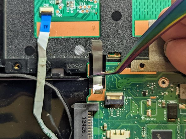

  35. ASUS VivoBook S400C Motherboard Replacement: crwdns2935265:035crwdnd2935265:01crwdnd2935265:02crwdne2935265:0 ASUS VivoBook S400C Motherboard Replacement: crwdns2935265:035crwdnd2935265:02crwdnd2935265:02crwdne2935265:0
    • Remove the first of the two conductive tapes grounding the trackpad.

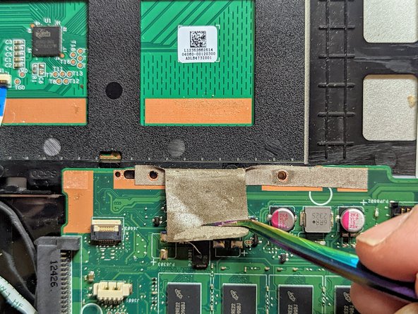

  36. ASUS VivoBook S400C Motherboard Replacement: crwdns2935265:036crwdnd2935265:01crwdnd2935265:02crwdne2935265:0 ASUS VivoBook S400C Motherboard Replacement: crwdns2935265:036crwdnd2935265:02crwdnd2935265:02crwdne2935265:0
    • Remove the second conductive tape grounding the trackpad.

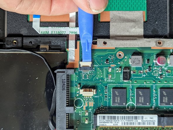

  37. ASUS VivoBook S400C Motherboard Replacement, Disconnect the LED Board Cable: crwdns2935265:037crwdnd2935265:01crwdnd2935265:03crwdne2935265:0 ASUS VivoBook S400C Motherboard Replacement, Disconnect the LED Board Cable: crwdns2935265:037crwdnd2935265:02crwdnd2935265:03crwdne2935265:0 ASUS VivoBook S400C Motherboard Replacement, Disconnect the LED Board Cable: crwdns2935265:037crwdnd2935265:03crwdnd2935265:03crwdne2935265:0
    • Use a spudger to flip up the LED board cable retainer.
  38. ASUS VivoBook S400C Motherboard Replacement: crwdns2935265:038crwdnd2935265:01crwdnd2935265:02crwdne2935265:0 ASUS VivoBook S400C Motherboard Replacement: crwdns2935265:038crwdnd2935265:02crwdnd2935265:02crwdne2935265:0
    • Pull the ribbon cable straight out from the connector.

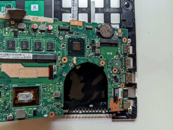

  42. ASUS VivoBook S400C Motherboard Replacement, Remove the Motherboard: crwdns2935265:042crwdnd2935265:01crwdnd2935265:02crwdne2935265:0 ASUS VivoBook S400C Motherboard Replacement, Remove the Motherboard: crwdns2935265:042crwdnd2935265:02crwdnd2935265:02crwdne2935265:0
    • Lift and slide the motherboard toward the hard drive to clear the connectors on the opposite side from the case.
