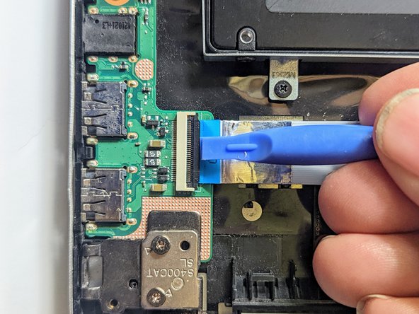

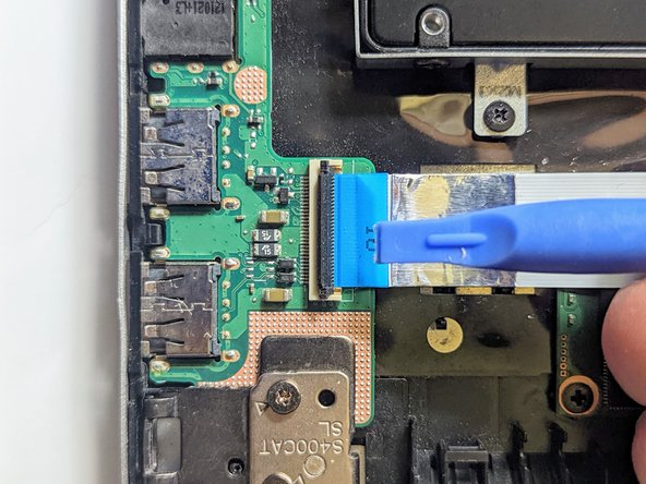

  4. ASUS VivoBook S400C I/O Board Replacement, I/O Board: crwdns2935265:04crwdnd2935265:01crwdnd2935265:03crwdne2935265:0 ASUS VivoBook S400C I/O Board Replacement, I/O Board: crwdns2935265:04crwdnd2935265:02crwdnd2935265:03crwdne2935265:0 ASUS VivoBook S400C I/O Board Replacement, I/O Board: crwdns2935265:04crwdnd2935265:03crwdnd2935265:03crwdne2935265:0
    • Flip up the retaining latch on the I/O board ribbon cable.
  5. ASUS VivoBook S400C I/O Board Replacement: crwdns2935265:05crwdnd2935265:01crwdnd2935265:02crwdne2935265:0 ASUS VivoBook S400C I/O Board Replacement: crwdns2935265:05crwdnd2935265:02crwdnd2935265:02crwdne2935265:0
    • Pull the cable straight out of the connector by the blue tab.

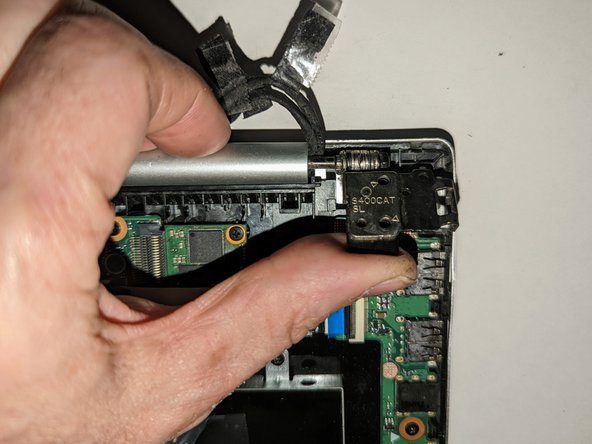

  6. ASUS VivoBook S400C I/O Board Replacement: crwdns2935265:06crwdnd2935265:01crwdnd2935265:02crwdne2935265:0 ASUS VivoBook S400C I/O Board Replacement: crwdns2935265:06crwdnd2935265:02crwdnd2935265:02crwdne2935265:0
    • Remove the two screws securing the left hinge to the I/O board.
    • Pry the hinge up by hand to a 90 degree angle.
