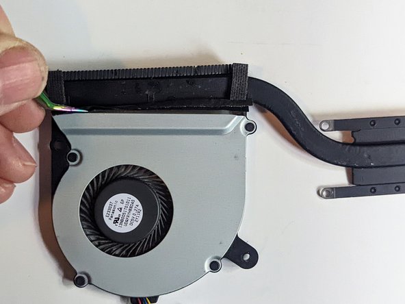

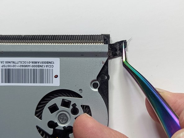

    • Flip the assembly over and peel off the tape wrapped around the edge of the fan.
  9. ASUS VivoBook S400C CPU Fan Replacement: crwdns2935265:09crwdnd2935265:01crwdnd2935265:03crwdne2935265:0 ASUS VivoBook S400C CPU Fan Replacement: crwdns2935265:09crwdnd2935265:02crwdnd2935265:03crwdne2935265:0 ASUS VivoBook S400C CPU Fan Replacement: crwdns2935265:09crwdnd2935265:03crwdnd2935265:03crwdne2935265:0

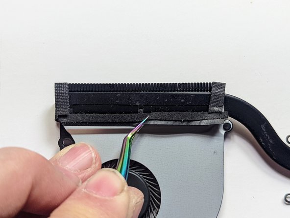

    • Starting at one end, carefully peel off the tape securing the heatsink to the lip of the fan.

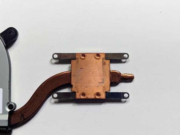

  11. ASUS VivoBook S400C CPU Fan Replacement, Clean the Heatsink: crwdns2935265:011crwdnd2935265:01crwdnd2935265:02crwdne2935265:0 ASUS VivoBook S400C CPU Fan Replacement, Clean the Heatsink: crwdns2935265:011crwdnd2935265:02crwdnd2935265:02crwdne2935265:0
    • Clean the old thermal paste off the heatsink until it is spotless.

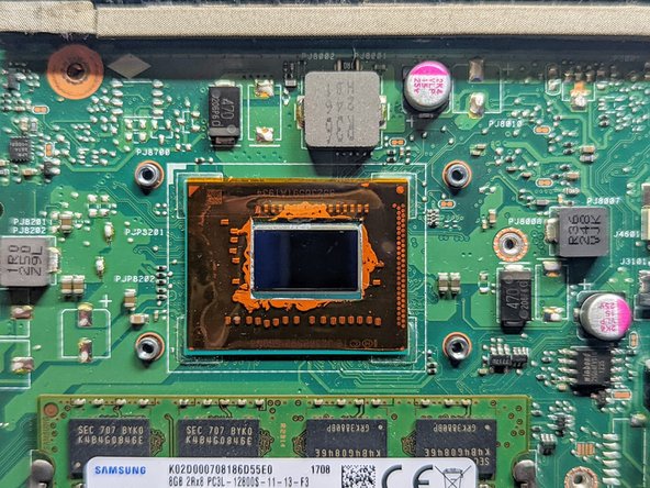

  12. ASUS VivoBook S400C CPU Fan Replacement, Clean the CPU: crwdns2935265:012crwdnd2935265:01crwdnd2935265:02crwdne2935265:0 ASUS VivoBook S400C CPU Fan Replacement, Clean the CPU: crwdns2935265:012crwdnd2935265:02crwdnd2935265:02crwdne2935265:0
    • Carefully remove the old thermal paste from the CPU. It is not vital to get the old paste off the parts of the chip under the Kapton tape, but be obsessive about cleaning the silicon chip itself and the area immediately next to it.
    • Do not fail to apply new thermal paste to the processor before reinstalling the heatsink. Failure to do so could lead to overheating and the possible death of your processor.
