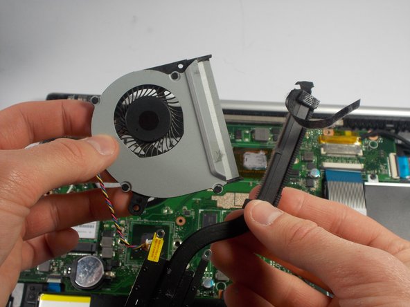

  6. ASUS VivoBook S300CA-BBI5T01 Fan Replacement: crwdns2935265:06crwdnd2935265:01crwdnd2935265:01crwdne2935265:0
    • Remove the fan and heat sink by lifting it upwards.
  7. ASUS VivoBook S300CA-BBI5T01 Fan Replacement: crwdns2935265:07crwdnd2935265:01crwdnd2935265:02crwdne2935265:0 ASUS VivoBook S300CA-BBI5T01 Fan Replacement: crwdns2935265:07crwdnd2935265:02crwdnd2935265:02crwdne2935265:0
    • Remove the tape holding the fan and heat sink together.
    • Before reassembly it is essential to clean off the old thermal paste from the processor and the heatsink and to apply new. How to apply thermal paste explains how.
