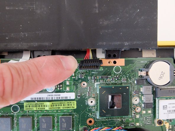

  4. ASUS VivoBook S300C keyboard Replacement, Remove the battery: crwdns2935265:04crwdnd2935265:01crwdnd2935265:02crwdne2935265:0 ASUS VivoBook S300C keyboard Replacement, Remove the battery: crwdns2935265:04crwdnd2935265:02crwdnd2935265:02crwdne2935265:0
    • Remove the screws holding the battery.
    • The battery is beneath two small prongs at the front of the cabinet.
    • To remove it lift it a little at the backside and pull it out a bit.
    • Remove the connection to the motherboard by lifting the cable gently. It has been pressed down into place and must be pulled directly up.

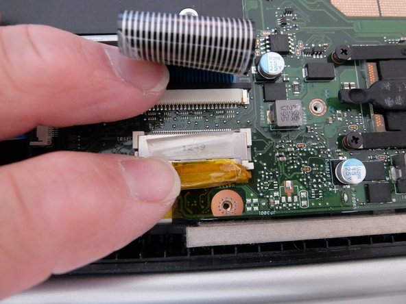

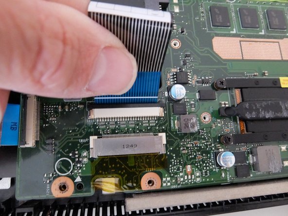

  5. ASUS VivoBook S300C keyboard Replacement, Removing different connections: crwdns2935265:05crwdnd2935265:01crwdnd2935265:03crwdne2935265:0 ASUS VivoBook S300C keyboard Replacement, Removing different connections: crwdns2935265:05crwdnd2935265:02crwdnd2935265:03crwdne2935265:0 ASUS VivoBook S300C keyboard Replacement, Removing different connections: crwdns2935265:05crwdnd2935265:03crwdnd2935265:03crwdne2935265:0
    • Remove the tape that keeps the flat cable (actually the keyboard cable) in place on top of the harddisk.
    • Pull the wide flat cable out of the connector on the motherboard.
    • Peel away the black protecting layer to get to the screen connector.
    • Pull the connector out of the socket on the motherboard.

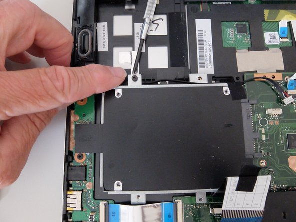

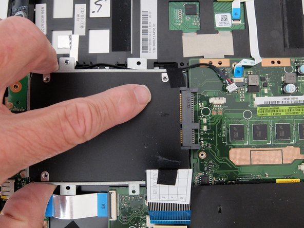

  6. ASUS VivoBook S300C keyboard Replacement, Removing the harddrive: crwdns2935265:06crwdnd2935265:01crwdnd2935265:03crwdne2935265:0 ASUS VivoBook S300C keyboard Replacement, Removing the harddrive: crwdns2935265:06crwdnd2935265:02crwdnd2935265:03crwdne2935265:0 ASUS VivoBook S300C keyboard Replacement, Removing the harddrive: crwdns2935265:06crwdnd2935265:03crwdnd2935265:03crwdne2935265:0
    • Disconnect the cable connected to motherboard and taped to the frontside of the harddrive, remove the tape from the harddrive.
    • Remove the screws attaching the harddrive and pull the harddrive of the the connector on the motherboard.

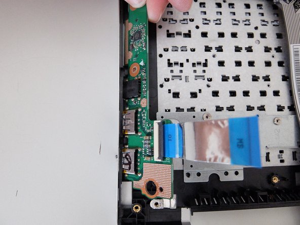

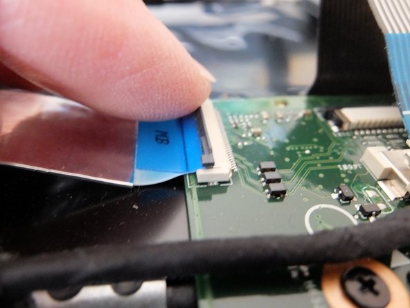

  7. ASUS VivoBook S300C keyboard Replacement, Disconnect sideboard: crwdns2935265:07crwdnd2935265:01crwdnd2935265:02crwdne2935265:0 ASUS VivoBook S300C keyboard Replacement, Disconnect sideboard: crwdns2935265:07crwdnd2935265:02crwdnd2935265:02crwdne2935265:0
    • Disconnect the sideboard (the smaller printboard at the side of the computer).
    • This connection is removed by flipping up a small retaining flap, whereafter the flat cable easily can be removed.

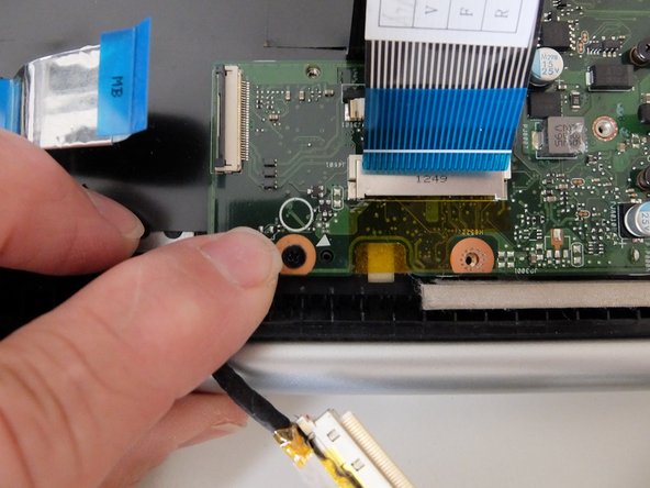

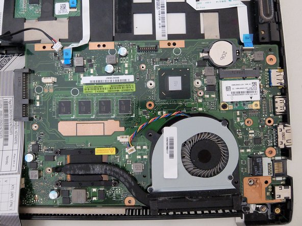

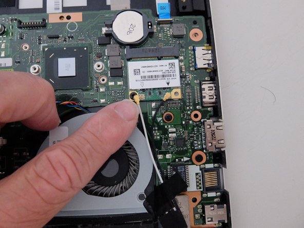

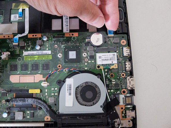

  8. ASUS VivoBook S300C keyboard Replacement, Disconnecting the rest: crwdns2935265:08crwdnd2935265:01crwdnd2935265:03crwdne2935265:0 ASUS VivoBook S300C keyboard Replacement, Disconnecting the rest: crwdns2935265:08crwdnd2935265:02crwdnd2935265:03crwdne2935265:0 ASUS VivoBook S300C keyboard Replacement, Disconnecting the rest: crwdns2935265:08crwdnd2935265:03crwdnd2935265:03crwdne2935265:0
    • Remove the protecting layer from the motherboard just beside the ventilator.
    • Disconnect gently the two small flat cables at the front of the motherboard.
    • Disconnect the black and white single cables from the motherboard.

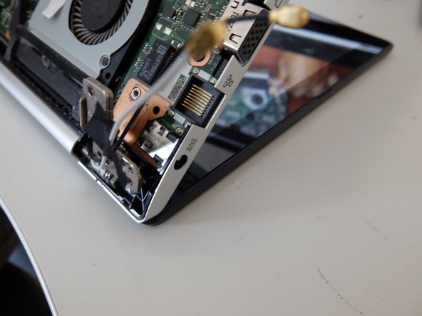

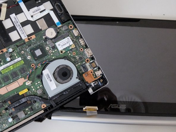

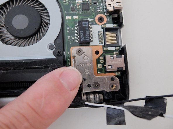

  9. ASUS VivoBook S300C keyboard Replacement, Removing the motherboard 1: crwdns2935265:09crwdnd2935265:01crwdnd2935265:03crwdne2935265:0 ASUS VivoBook S300C keyboard Replacement, Removing the motherboard 1: crwdns2935265:09crwdnd2935265:02crwdnd2935265:03crwdne2935265:0 ASUS VivoBook S300C keyboard Replacement, Removing the motherboard 1: crwdns2935265:09crwdnd2935265:03crwdnd2935265:03crwdne2935265:0
    • Remove the ventilator connection from the motherboard.
    • Remove the screws retaining the motherboard, that includes two screws holding the ventilator and two screws attaching the screen.
    • By opening the computer a little you can now turn the hinge connecting the screen to the computer.
    • Close the computer again and open the hinge completely, so that it stands at a right angle to the motherboard.
    • Now if you have removed all screws from it you can remove the motherboard.
    • But be careful with the connectors to external units on the side. Lift the motherboard a little on the other side and then pull it away from the side with the connectors.
    • Remove the screws on the screen hinge on the other side and repeat the manoeuvre to open the hinge to vertical.
    • Tip the computer a little leaving the screen on the table. Now you can unhinge the screen and put it aside.

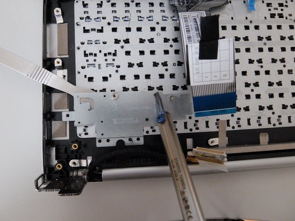

  11. ASUS VivoBook S300C keyboard Replacement, Removing the keyboard: crwdns2935265:013crwdnd2935265:01crwdnd2935265:02crwdne2935265:0 ASUS VivoBook S300C keyboard Replacement, Removing the keyboard: crwdns2935265:013crwdnd2935265:02crwdnd2935265:02crwdne2935265:0
    • Using a soldering iron melt the plastic keeping the the two small metal plates on the backside of the keyboard in place.
    • Again using the soldering iron melt the plastic keeping the keyboard in place.
    • This step requires some patience. You have to start at one corner and slowly lift the keyboard when the plastic melts.
    • Don't rip it away with force as the plastic will be torn away and should be used to attach the new keyboard.
    • When the keyboard is loose there are still some tapestrips connected it. Remove these and then remove the old keyboard.
