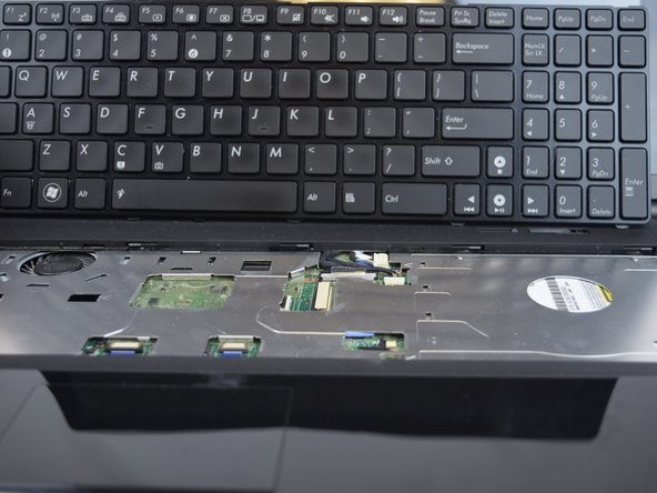

    • Make sure the device is powered off and the battery is removed before beginning.
    • Use the Plastic Opening tool to pry the five slots up at the top of the keyboard.
  2. ASUS UX50V-RX05 Motherboard Replacement: crwdns2935265:02crwdnd2935265:01crwdnd2935265:02crwdne2935265:0 ASUS UX50V-RX05 Motherboard Replacement: crwdns2935265:02crwdnd2935265:02crwdnd2935265:02crwdne2935265:0
    • Lift the keyboard enough to expose the two ribbon connectors (LCD flex cable and flex band).
    • Use the Plastic Opening tool to push open the two black clips on each side of the connecting cords.
    • Remove the cable after pushing out the two black clips.
  3. ASUS UX50V-RX05 Motherboard Replacement: crwdns2935265:03crwdnd2935265:01crwdnd2935265:02crwdne2935265:0 ASUS UX50V-RX05 Motherboard Replacement: crwdns2935265:03crwdnd2935265:02crwdnd2935265:02crwdne2935265:0
    • Push out each end of the black clip with a plastic opening tool or nylon spudger to remove the ribbon cable.
    • Remove the cable after pushing out both black clips.
    • Remove the keyboard.

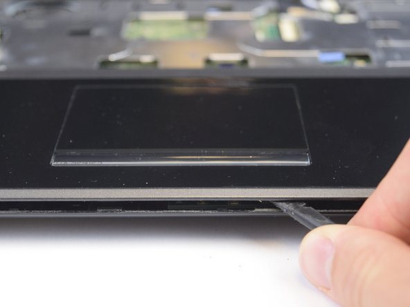

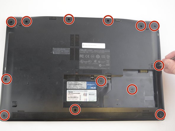

  4. ASUS UX50V-RX05 Motherboard Replacement, Case Removal: crwdns2935265:04crwdnd2935265:01crwdnd2935265:03crwdne2935265:0 ASUS UX50V-RX05 Motherboard Replacement, Case Removal: crwdns2935265:04crwdnd2935265:02crwdnd2935265:03crwdne2935265:0 ASUS UX50V-RX05 Motherboard Replacement, Case Removal: crwdns2935265:04crwdnd2935265:03crwdnd2935265:03crwdne2935265:0
    • Remove the thirteen 5 mm J0 screws from the back of the laptop.
    • With the keyboard removed, use the spudger tool to pry around the edge of the laptop until it is free.

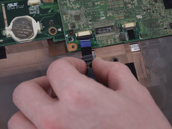

  5. ASUS UX50V-RX05 Motherboard Replacement: crwdns2935265:05crwdnd2935265:01crwdnd2935265:02crwdne2935265:0 ASUS UX50V-RX05 Motherboard Replacement: crwdns2935265:05crwdnd2935265:02crwdnd2935265:02crwdne2935265:0

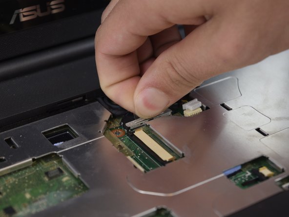

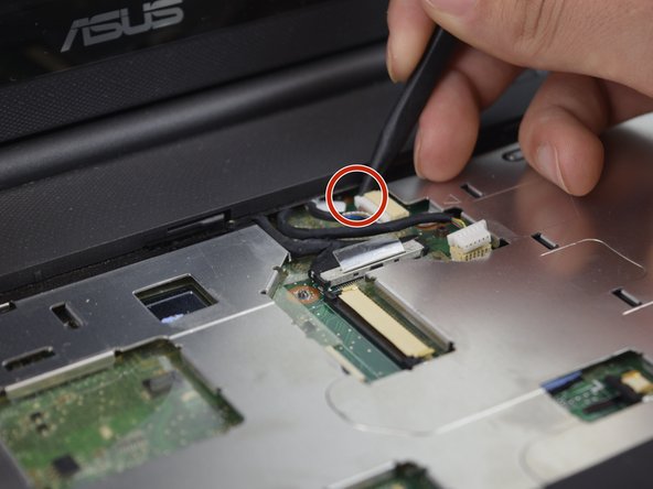

    • Use the spudger tool to unplug the two cords from the body by pushing on the tabs on both sides of the plug.

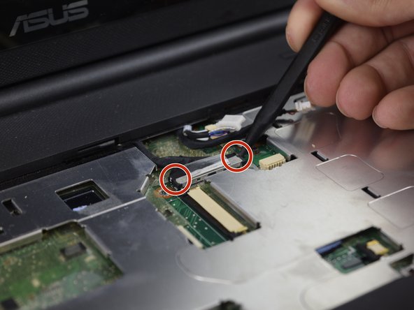

  6. ASUS UX50V-RX05 Motherboard Replacement: crwdns2935265:06crwdnd2935265:01crwdnd2935265:03crwdne2935265:0 ASUS UX50V-RX05 Motherboard Replacement: crwdns2935265:06crwdnd2935265:02crwdnd2935265:03crwdne2935265:0 ASUS UX50V-RX05 Motherboard Replacement: crwdns2935265:06crwdnd2935265:03crwdnd2935265:03crwdne2935265:0
    • With the previous two cords unplugged and out of the way, you can work on unplugging the black cord.
    • Use your fingers to pull up on the clear tab, or use the spudger tool to push out both sides of the connector.

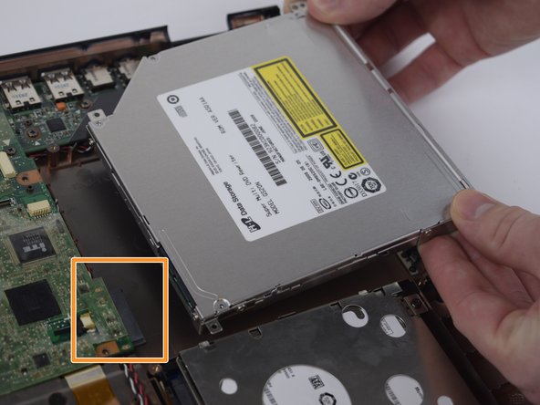

  8. ASUS UX50V-RX05 Motherboard Replacement, Optical Drive: crwdns2935265:08crwdnd2935265:01crwdnd2935265:02crwdne2935265:0 ASUS UX50V-RX05 Motherboard Replacement, Optical Drive: crwdns2935265:08crwdnd2935265:02crwdnd2935265:02crwdne2935265:0
    • Remove the four 5 mm J0 screws surrounding the Optical Drive.
    • Remove the optical drive by pulling it out and away from the connector.

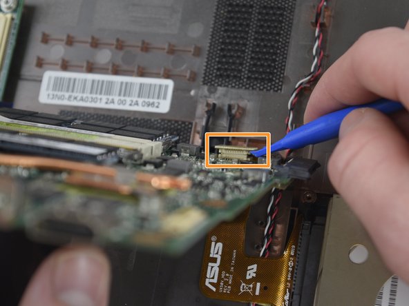

  9. ASUS UX50V-RX05 Motherboard Replacement, Motherboard: crwdns2935265:09crwdnd2935265:01crwdnd2935265:03crwdne2935265:0 ASUS UX50V-RX05 Motherboard Replacement, Motherboard: crwdns2935265:09crwdnd2935265:02crwdnd2935265:03crwdne2935265:0 ASUS UX50V-RX05 Motherboard Replacement, Motherboard: crwdns2935265:09crwdnd2935265:03crwdnd2935265:03crwdne2935265:0

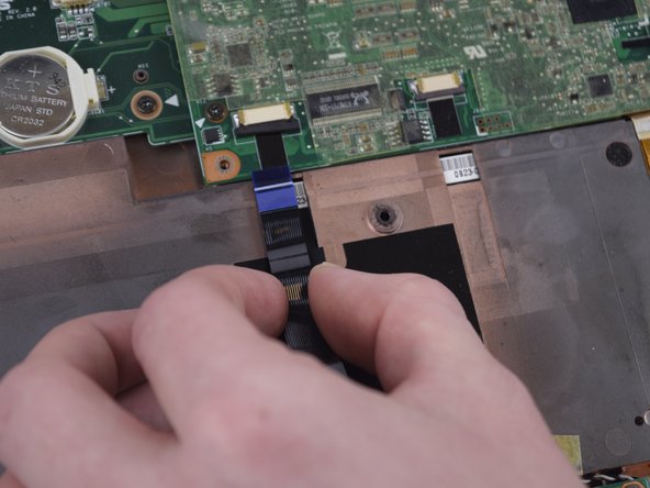

    • Use the Plastic Opening Tool to unplug the blue cord on the Motherboard.

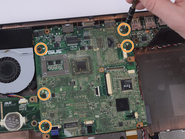

  10. ASUS UX50V-RX05 Motherboard Replacement: crwdns2935265:010crwdnd2935265:01crwdnd2935265:02crwdne2935265:0 ASUS UX50V-RX05 Motherboard Replacement: crwdns2935265:010crwdnd2935265:02crwdnd2935265:02crwdne2935265:0
    • Remove the five 4 mm Phillips head 5 mm long screws that have white arrows pointing to them with the screwdriver.

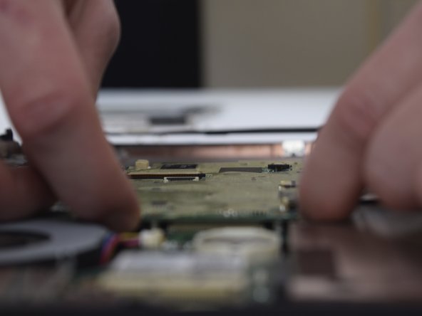

  11. ASUS UX50V-RX05 Motherboard Replacement: crwdns2935265:011crwdnd2935265:01crwdnd2935265:03crwdne2935265:0 ASUS UX50V-RX05 Motherboard Replacement: crwdns2935265:011crwdnd2935265:02crwdnd2935265:03crwdne2935265:0 ASUS UX50V-RX05 Motherboard Replacement: crwdns2935265:011crwdnd2935265:03crwdnd2935265:03crwdne2935265:0
    • Lift the Motherboard with your fingers by reaching underneath the Motherboard and prying.

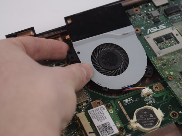

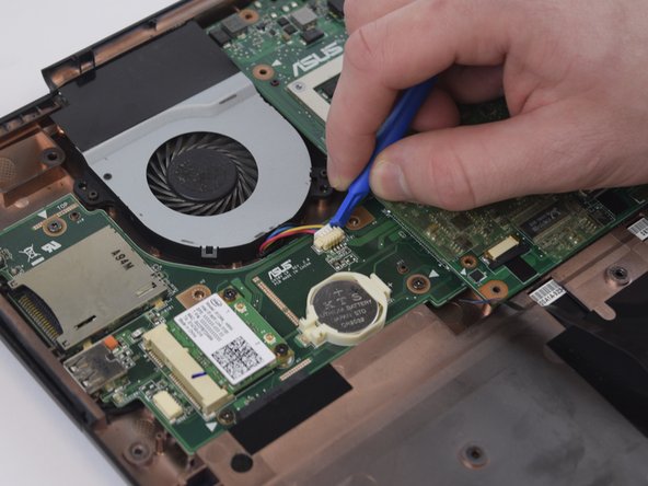

  12. ASUS UX50V-RX05 Motherboard Replacement: crwdns2935265:012crwdnd2935265:01crwdnd2935265:03crwdne2935265:0 ASUS UX50V-RX05 Motherboard Replacement: crwdns2935265:012crwdnd2935265:02crwdnd2935265:03crwdne2935265:0 ASUS UX50V-RX05 Motherboard Replacement: crwdns2935265:012crwdnd2935265:03crwdnd2935265:03crwdne2935265:0
    • Remove the two 4 mm Phillips head 5 mm long screws from the fan using the screwdriver.
    • Using the Spudger, carefully remove the white connector and lift the fan out of the casing.

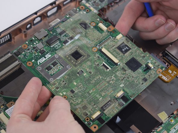

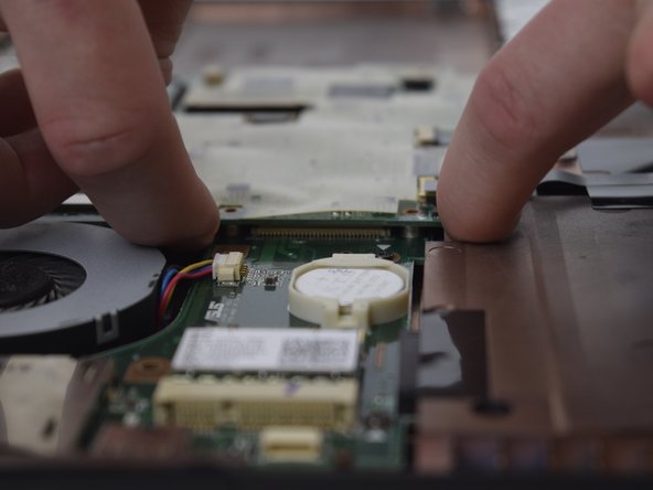

  13. ASUS UX50V-RX05 Motherboard Replacement: crwdns2935265:013crwdnd2935265:01crwdnd2935265:03crwdne2935265:0 ASUS UX50V-RX05 Motherboard Replacement: crwdns2935265:013crwdnd2935265:02crwdnd2935265:03crwdne2935265:0 ASUS UX50V-RX05 Motherboard Replacement: crwdns2935265:013crwdnd2935265:03crwdnd2935265:03crwdne2935265:0
    • Slowly lift the motherboard up towards you being careful as to not rip any cords out of the bottom.
    • Using the Spudger, remove the connector towards the bottom of the motherboard.
    • Remove the motherboard from the casing.
