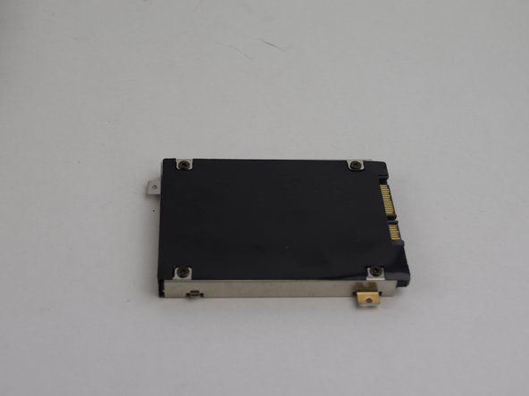

    1. ASUS UX50V-RX05 Hard Drive Replacement, Hard Drive: crwdns2935265:08crwdnd2935265:01crwdnd2935265:02crwdne2935265:0 ASUS UX50V-RX05 Hard Drive Replacement, Hard Drive: crwdns2935265:08crwdnd2935265:02crwdnd2935265:02crwdne2935265:0
      • Using the screwdriver with the JO bit, remove the two Phillips 4 mm head size 5 mm long screws from the Hard Drive.
    2. ASUS UX50V-RX05 Hard Drive Replacement: crwdns2935265:09crwdnd2935265:01crwdnd2935265:02crwdne2935265:0 ASUS UX50V-RX05 Hard Drive Replacement: crwdns2935265:09crwdnd2935265:02crwdnd2935265:02crwdne2935265:0
      • Flip the Hard Drive over without lifting.
      • Using your fingers, unplug the cord by pulling it away from the hard drive.
    3. ASUS UX50V-RX05 Hard Drive Replacement: crwdns2935265:010crwdnd2935265:01crwdnd2935265:01crwdne2935265:0
      • Unscrew the four black screws from the Hard Drive and slide it out.
