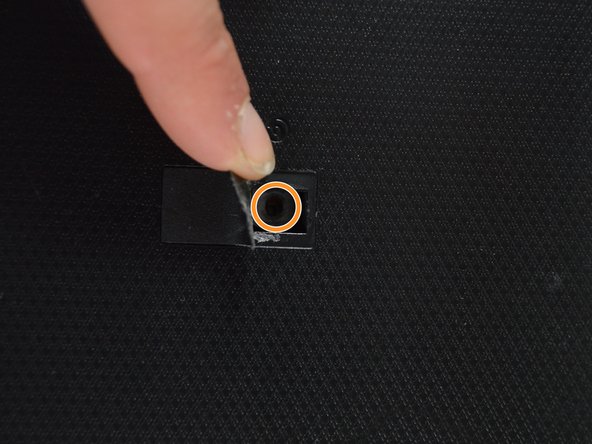

    • Remove the two 2 mm Phillips head screws on each side on the bottom using PH00 screw driver.
    • Remove the one 2 mm screw underneath the black cover in the middle using the same screw driver.

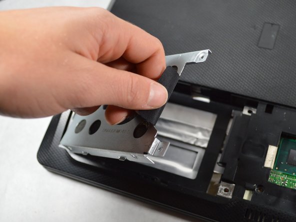

    • Remove the three 2 mm Phillips head screws on the hard drive using PH00 screw driver.
    • Remove the remaining seven 1.8 mm Phillips head screws using the same screw driver.
  7. ASUS U57A-BBL4 Motherboard Replacement: crwdns2935265:07crwdnd2935265:01crwdnd2935265:02crwdne2935265:0 ASUS U57A-BBL4 Motherboard Replacement: crwdns2935265:07crwdnd2935265:02crwdnd2935265:02crwdne2935265:0
    • Remove the hard drive by sliding it to the left and lifting up.

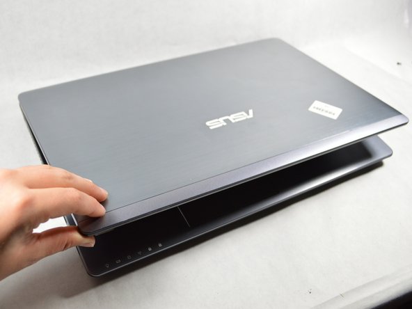

    • Remove the six 2 mm Phillips head screws on the top edge of the laptop using PH00 screw driver.
    • Flip the laptop right-side up and open the screen.

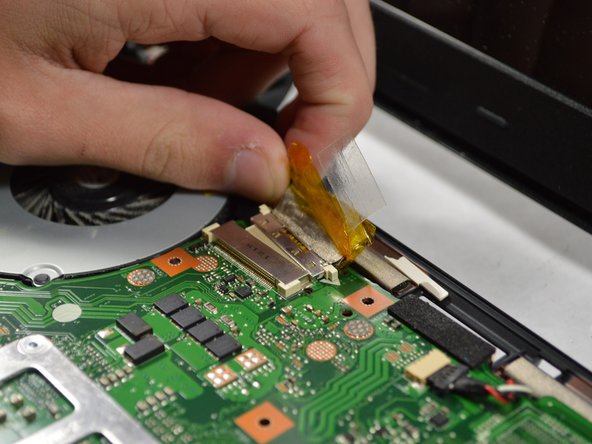

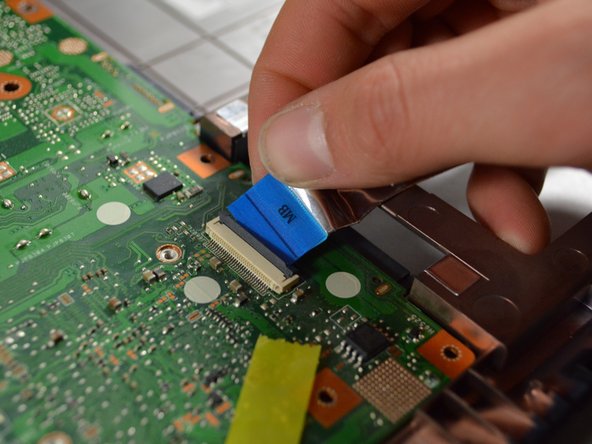

    • Remove the blue cable on the bottom right by lifting up on the tab and pulling the cable out.

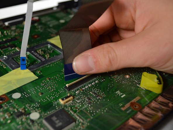

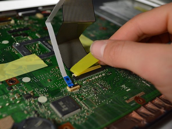

  13. ASUS U57A-BBL4 Motherboard Replacement: crwdns2935265:013crwdnd2935265:01crwdnd2935265:03crwdne2935265:0 ASUS U57A-BBL4 Motherboard Replacement: crwdns2935265:013crwdnd2935265:02crwdnd2935265:03crwdne2935265:0 ASUS U57A-BBL4 Motherboard Replacement: crwdns2935265:013crwdnd2935265:03crwdnd2935265:03crwdne2935265:0

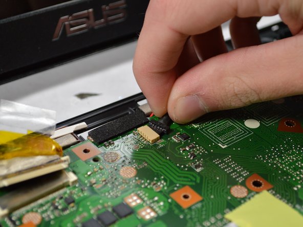

    • Peel off the black and yellow tape attaching the fan to the base.
    • Peel the tape off the yellow cable and pull out to remove the cable.
    • Remove the small black, white and red cable next to the yellow cable at the top.
