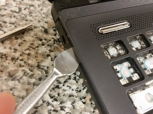

  3. ASUS U57A-BBL4 Keyboard Replacement, Separate palmrest from base: crwdns2935265:03crwdnd2935265:01crwdnd2935265:02crwdne2935265:0 ASUS U57A-BBL4 Keyboard Replacement, Separate palmrest from base: crwdns2935265:03crwdnd2935265:02crwdnd2935265:02crwdne2935265:0
    • Remove the eight longer Philips screws securing the palmrest to the base.
    • Remove thet four longer and thicker Philips screws securing the palmrest to the base.
    • Remove the single remaining small Philips screw securing the palmrest to the base.
    • Remove the cover hiding the last remaining, medium-length Philips screw.
    • Use a spudger to separate the palmrest from the base.

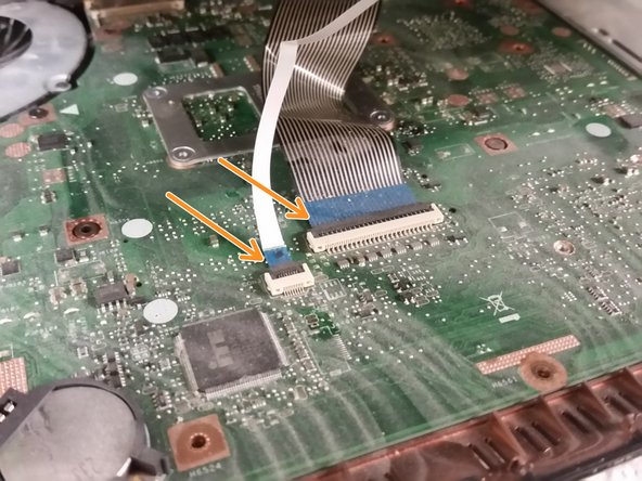

  4. ASUS U57A-BBL4 Keyboard Replacement, Remove palmrest cables & palmrest: crwdns2935265:04crwdnd2935265:01crwdnd2935265:02crwdne2935265:0 ASUS U57A-BBL4 Keyboard Replacement, Remove palmrest cables & palmrest: crwdns2935265:04crwdnd2935265:02crwdnd2935265:02crwdne2935265:0
    • Slowly move the palmrest to the right, until you begin to see a ZIF cable. Stop moving the palmrest once you see the cable. Remove the cable.
    • Now, lift the palmrest up slowly, until you see more ZIF cables. Remove both of them.
    • There are no more cables, so you may now take the palmrest away from the laptop.
