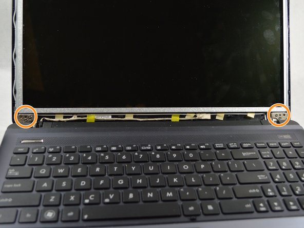

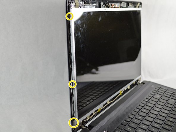

  4. ASUS U57A-BBL4 Display Assembly Replacement: crwdns2935265:04crwdnd2935265:01crwdnd2935265:03crwdne2935265:0 ASUS U57A-BBL4 Display Assembly Replacement: crwdns2935265:04crwdnd2935265:02crwdnd2935265:03crwdne2935265:0 ASUS U57A-BBL4 Display Assembly Replacement: crwdns2935265:04crwdnd2935265:03crwdnd2935265:03crwdne2935265:0
    • Remove the top two 2 mm Phillips head screws.
    • Remove the four 2 mm Phillips head screws on the bottom.
    • Remove the eight 2 mm Phillips head screws on the sides of the screen. There are four on each side.
    • There are 14 screws in total: two on the top, four on the bottom, and four on each side. Use PH00 screw-driver for removing all 14 screws.

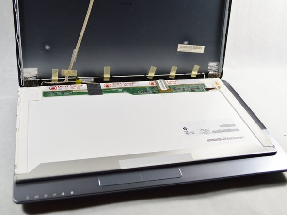

  5. ASUS U57A-BBL4 Display Assembly Replacement: crwdns2935265:05crwdnd2935265:01crwdnd2935265:02crwdne2935265:0 ASUS U57A-BBL4 Display Assembly Replacement: crwdns2935265:05crwdnd2935265:02crwdnd2935265:02crwdne2935265:0
    • Don't tear off the bottom of the screen or you might damage the connector cable.
    • Carefully lower the screen from the casing with your fingers, making sure to keep the bottom intact and lay it face down on the keyboard.

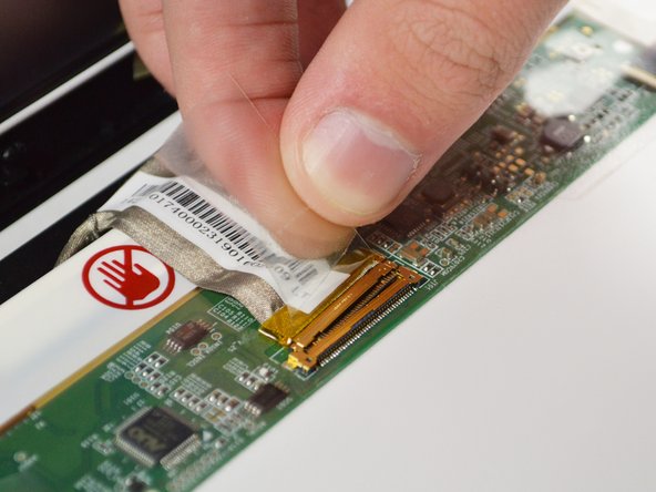

  6. ASUS U57A-BBL4 Display Assembly Replacement: crwdns2935265:06crwdnd2935265:01crwdnd2935265:02crwdne2935265:0 ASUS U57A-BBL4 Display Assembly Replacement: crwdns2935265:06crwdnd2935265:02crwdnd2935265:02crwdne2935265:0
    • Disconnect the connector cable at the bottom by loosening the adhesive tape and lifting up.
    • Gently slide the cable out of the ridges to free the screen from the casing.
