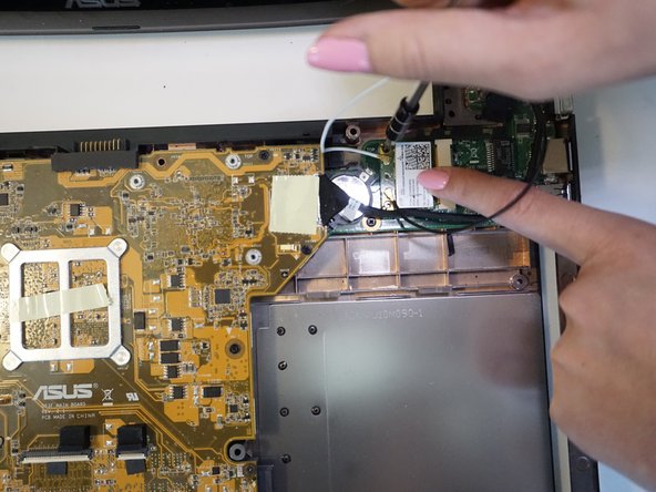

  9. ASUS U52F-BBG6 Wi-Fi Chip Replacement, Wi-fi Chip: crwdns2935265:09crwdnd2935265:01crwdnd2935265:01crwdne2935265:0
    • Find the Wi-Fi chip circuit board, which has a white sticker on it and is connected to a black and white wire.
  10. ASUS U52F-BBG6 Wi-Fi Chip Replacement: crwdns2935265:010crwdnd2935265:01crwdnd2935265:02crwdne2935265:0 ASUS U52F-BBG6 Wi-Fi Chip Replacement: crwdns2935265:010crwdnd2935265:02crwdnd2935265:02crwdne2935265:0
    • Unscrew the two 3mm Phillips screws using a J1 screwdriver to release the Wi-Fi chip.
  11. ASUS U52F-BBG6 Wi-Fi Chip Replacement: crwdns2935265:011crwdnd2935265:01crwdnd2935265:02crwdne2935265:0 ASUS U52F-BBG6 Wi-Fi Chip Replacement: crwdns2935265:011crwdnd2935265:02crwdnd2935265:02crwdne2935265:0
    • Pull out the Wi-Fi chip
  12. ASUS U52F-BBG6 Wi-Fi Chip Replacement: crwdns2935265:012crwdnd2935265:01crwdnd2935265:01crwdne2935265:0
    • Pull off both wires from the chip.
    • It's advised to label the wires to remember where each colored wire connects to on the circuit board.
