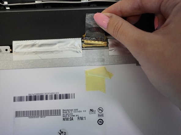

  6. ASUS U52F-BBG6 Screen Replacement: crwdns2935265:06crwdnd2935265:01crwdnd2935265:02crwdne2935265:0 ASUS U52F-BBG6 Screen Replacement: crwdns2935265:06crwdnd2935265:02crwdnd2935265:02crwdne2935265:0
    • Lay the screen down flat on the keyboard.
    • Peel the yellow tape and then the metallic tape holding the screen's connection to the computer.
    • The metallic tape is hidden underneath the yellow tape.
  7. ASUS U52F-BBG6 Screen Replacement: crwdns2935265:07crwdnd2935265:01crwdnd2935265:03crwdne2935265:0 ASUS U52F-BBG6 Screen Replacement: crwdns2935265:07crwdnd2935265:02crwdnd2935265:03crwdne2935265:0 ASUS U52F-BBG6 Screen Replacement: crwdns2935265:07crwdnd2935265:03crwdnd2935265:03crwdne2935265:0
    • Unlatch the golden connector under the metallic tape using the flat side of the nylon spudger.
    • Gently lift the connector and peel the metallic tape to detach the wire on your right that holds it in place.
    • Lift the now freed screen.
