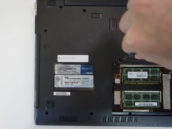

    • Unscrew all twelve 3mm Phillips screws with the J1 screwdriver.
    • Unscrew two 3mm Phillips screws on the black panel using the PH0 screwdriver.
    • Lift the black panel upward by inserting your fingernail in the space provided.

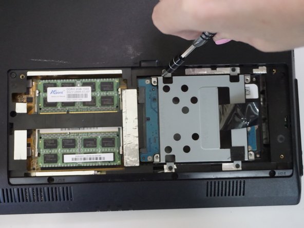

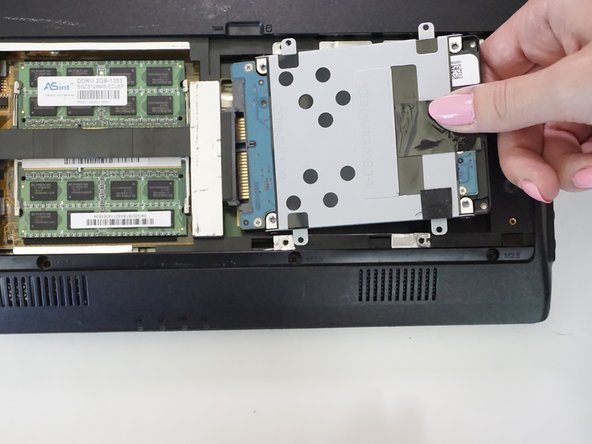

    • In the RAM and hard drive compartment, unscrew the four 3mm Phillips screws using the J1 screwdriver.
    • Gently pull out the hard drive.
  4. ASUS U52F-BBG6 Keyboard Replacement: crwdns2935265:04crwdnd2935265:01crwdnd2935265:02crwdne2935265:0 ASUS U52F-BBG6 Keyboard Replacement: crwdns2935265:04crwdnd2935265:02crwdnd2935265:02crwdne2935265:0
    • Unscrew six 3mm Phillips screws in the RAM and hard drive compartment with the J1 screwdriver.

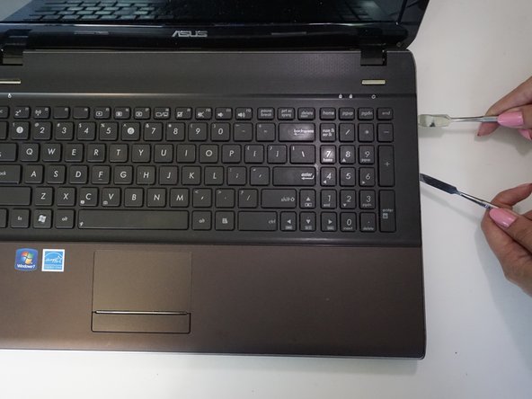

    • Insert and gently twist the flat metal spudger between the keyboard assembly and the bottom plastic cover so that a small seam is opened.
    • Put in the metal spudger in the seam to hold its place while twisting and levering the flat metal spudger along the whole keyboard.
    • Be careful not to hit any of the internals with the metal spudger. The regular black nylon spudger should be used whenever possible, especially around batteries or sensitive internal components.
    • You will need add a lot of pressure to open the laptop. Expect to hear snaps as the clips holding the two pieces are released.
    • Slowly pry off the back

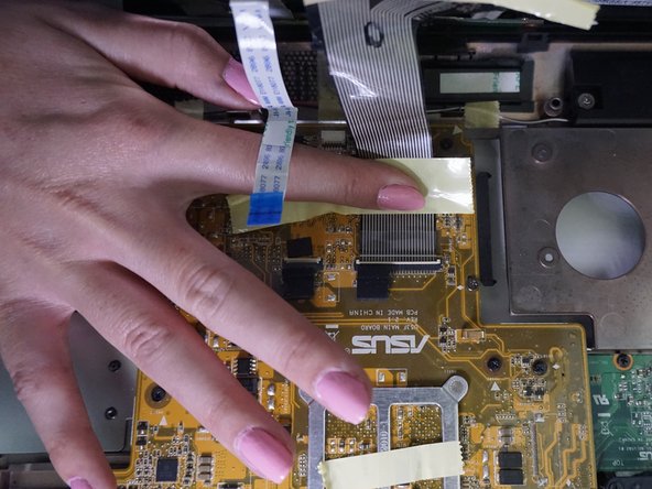

    • Unlatch the clip attaching the white flattened flexible cord with a blue tip to the circuit board with your thumb.
    • Pull out the white flattened cord.
  8. ASUS U52F-BBG6 Keyboard Replacement: crwdns2935265:08crwdnd2935265:01crwdnd2935265:01crwdne2935265:0
    • Pull back yellow tape attaching the metal colored flexible flattened cord to the circuit board.
    • Lift up the latch at the end of the cord.
    • Pull out the cord to release the keyboard.
