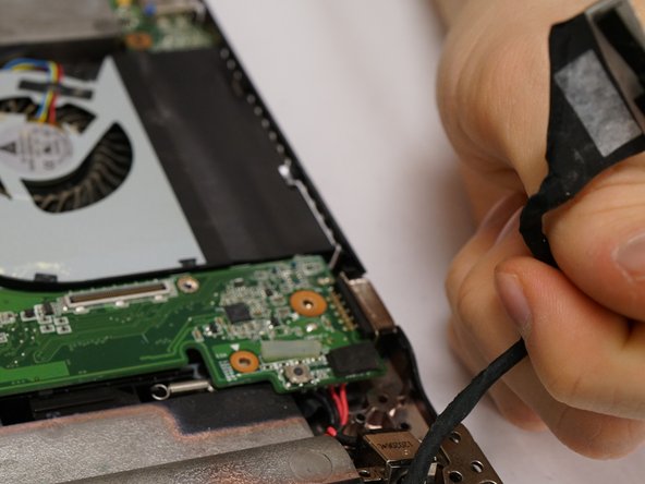

    • Use the straight tweezers to disconnect the wires attaching the screen to the main computer by pulling up gently. The computer screen should be open and away from you.

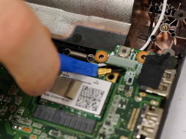

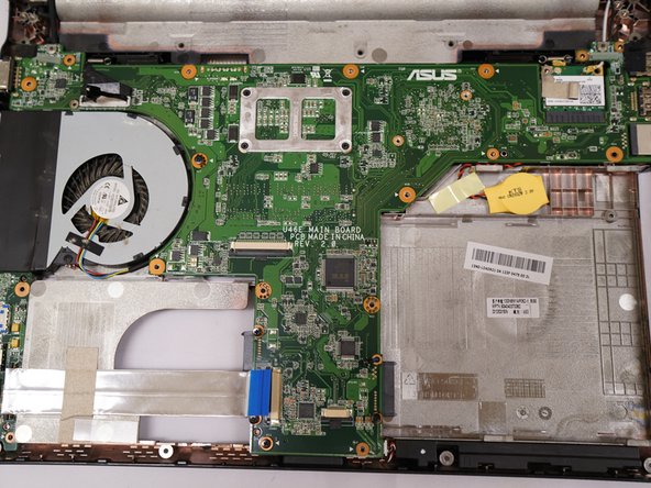

    • Remove two (2) 5mm x 4mm screws from the upper right hand corner of the motherboard with the size 0 Phillips screwdriver.
  12. ASUS U46E-RAL7 Screen Replacement: crwdns2935265:012crwdnd2935265:01crwdnd2935265:03crwdne2935265:0 ASUS U46E-RAL7 Screen Replacement: crwdns2935265:012crwdnd2935265:02crwdnd2935265:03crwdne2935265:0 ASUS U46E-RAL7 Screen Replacement: crwdns2935265:012crwdnd2935265:03crwdnd2935265:03crwdne2935265:0
    • Remove one (1) 5mm x 4mm screw from the upper left hand corner of the motherboard with the size 0 Phillips screwdriver.
  13. ASUS U46E-RAL7 Screen Replacement: crwdns2935265:013crwdnd2935265:01crwdnd2935265:01crwdne2935265:0
    • Lift up the corner of the motherboard on both sides and disconnect the wires connecting the screen by pulling gently.

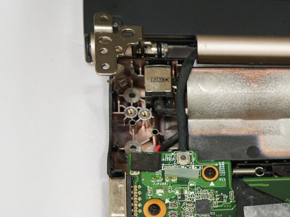

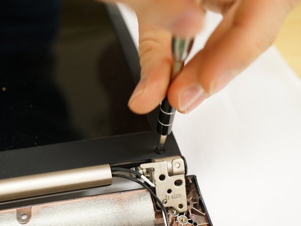

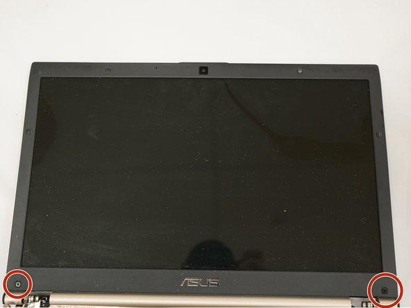

    • Use tweezers to remove both plastic screw cover.
    • Remove two (2) 5mm x 4mm screws with the size 0 Phillips screwdriver.

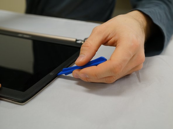

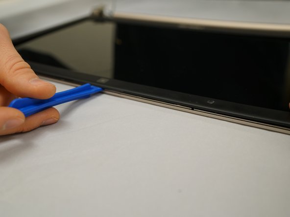

    • With the hinges facing towards you, use the plastic opening tool to pry up next to the hinges and work all the way around the screen.
    • The casing will be difficult to separate. The clips secure the casing together and may break as you remove the casing.

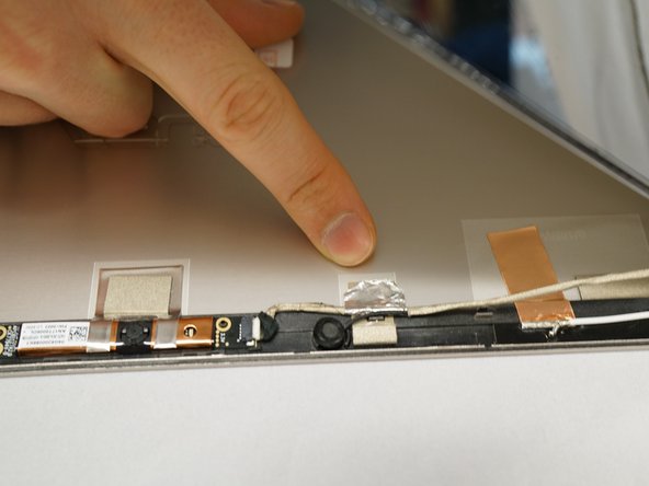

    • Remove the 4 pin connecter from behind the screen.

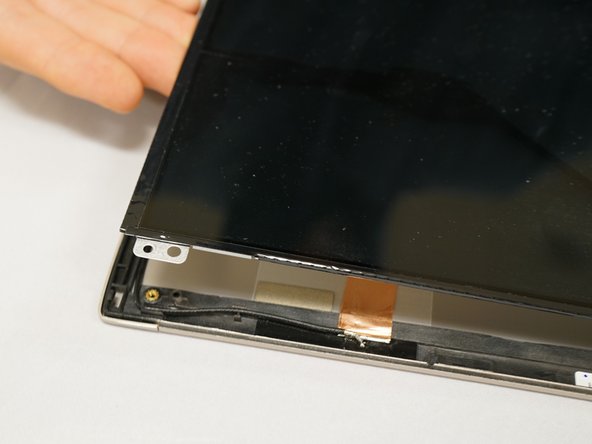

    • Lift up the LCD screen. Remove and pull away the tape as you lift the screen out. Screen will pull away easily once the tape is removed.
  17. ASUS U46E-RAL7 Screen Replacement: crwdns2935265:017crwdnd2935265:01crwdnd2935265:01crwdne2935265:0
    • Lift the screen away from the back holder.
