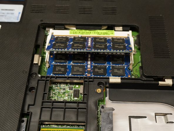

    • Place both index fingers on the metal bars on the edge of the ram.
    • Press down gently until the RAM pops up.
  4. ASUS U46E-RAL7 RAM Replacement: crwdns2935265:04crwdnd2935265:01crwdnd2935265:01crwdne2935265:0

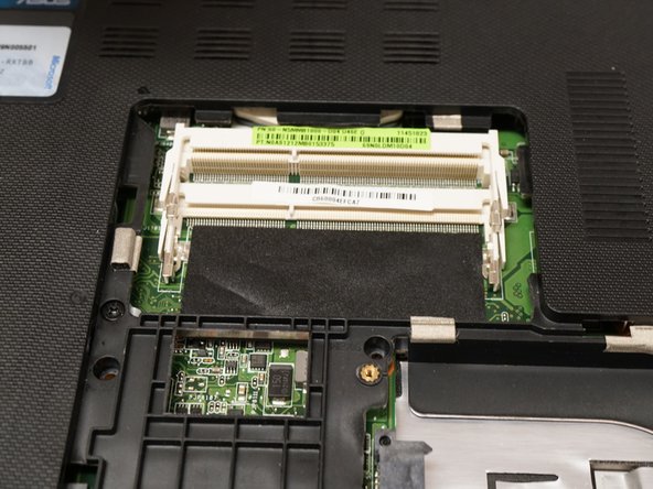

    • Pull the RAM stick out of the socket.
  5. ASUS U46E-RAL7 RAM Replacement: crwdns2935265:05crwdnd2935265:01crwdnd2935265:02crwdne2935265:0 ASUS U46E-RAL7 RAM Replacement: crwdns2935265:05crwdnd2935265:02crwdnd2935265:02crwdne2935265:0
    • Repeat steps 1-4 for the second stick of RAM.
