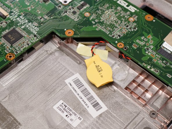

    • Disconnect one (1) white/red/black connector wire by prying it up with the spudger.
  13. ASUS U46E-RAL7 Motherboard Replacement: crwdns2935265:013crwdnd2935265:01crwdnd2935265:01crwdne2935265:0
    • Disconnect one (1) red/black connector wires by prying them out with the nylon spudger.

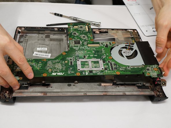

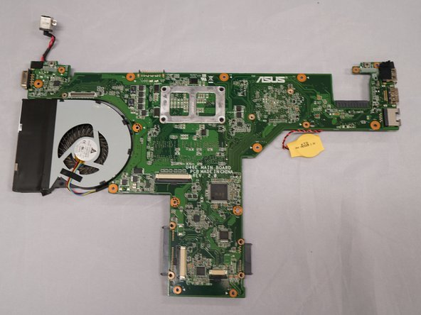

  14. ASUS U46E-RAL7 Motherboard Replacement: crwdns2935265:014crwdnd2935265:01crwdnd2935265:03crwdne2935265:0 ASUS U46E-RAL7 Motherboard Replacement: crwdns2935265:014crwdnd2935265:02crwdnd2935265:03crwdne2935265:0 ASUS U46E-RAL7 Motherboard Replacement: crwdns2935265:014crwdnd2935265:03crwdnd2935265:03crwdne2935265:0
    • Insert index fingers underneath the motherboard in the top corners of the motherboard. Slowly move your fingers toward the center of the board while lifting up gently. The motherboard will lift easily from the device casing.
