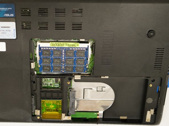

    • Remove two (2) 9mm x 4mm screws from the back panel with the size 0 Phillips head screwdriver.
    • Remove two (2) 7mm x 4mm screws from the back panel with the size 0 Phillips head screwdriver.
    • Remove six (6) 7mm x 4mm screws with the size 0 Phillips head screwdriver.
    • Remove three (3) 3mm x 3mm screws with the size 0 Phillips head screwdriver.
    • Remove one (1) 4mm x 4mm screws with the size 0 Phillips head screwdriver.

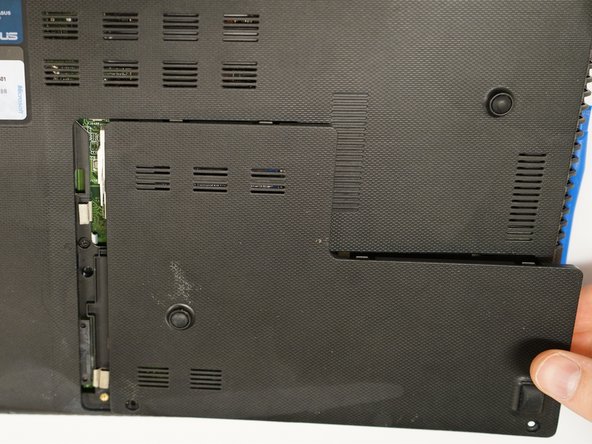

    • Remove the L shaped panel with the plastic opening tool by inserting it into the indent along the USB port side of the laptop.
    • Push down gently on the plastic opening tool until part of the panel pops up.
    • Use your fingers to pop the panel off.

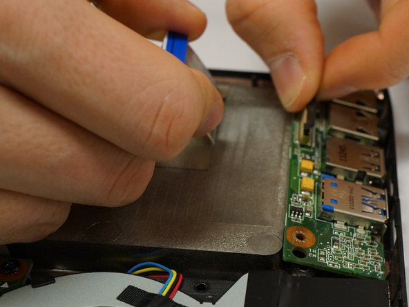

    • Remove three (3) 5mm x 4mm screws with the size 0 Phillips head screwdriver.
    • Remove one (1) 4mm x 4mm (closest to the battery) screw with the size 0 Phillips head screwdriver.

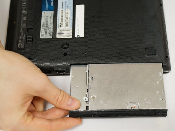

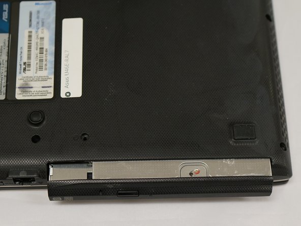

    • Remove the CD ROM drive by inserting the plastic opening tool between the drive and the laptop's side.
    • Push down gently to eject the drive.
    • Pull the drive straight out to remove the part from the laptop.

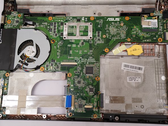

  9. ASUS U46E-RAL7 Audio Board Replacement: crwdns2935265:09crwdnd2935265:01crwdnd2935265:02crwdne2935265:0 ASUS U46E-RAL7 Audio Board Replacement: crwdns2935265:09crwdnd2935265:02crwdnd2935265:02crwdne2935265:0
    • Remove the keyboard from the computer to reveal the motherboard.

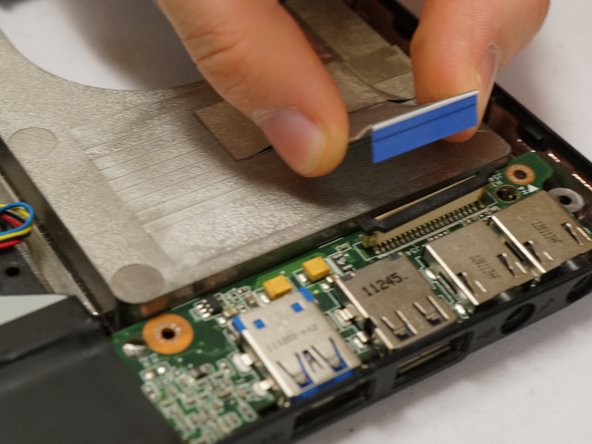

  10. ASUS U46E-RAL7 Audio Board Replacement, Audio Board: crwdns2935265:010crwdnd2935265:01crwdnd2935265:01crwdne2935265:0
    • Remove one (1) 5mm x 4mm screw with the size 0 Phillips head screwdriver.
  11. ASUS U46E-RAL7 Audio Board Replacement: crwdns2935265:011crwdnd2935265:01crwdnd2935265:03crwdne2935265:0 ASUS U46E-RAL7 Audio Board Replacement: crwdns2935265:011crwdnd2935265:02crwdnd2935265:03crwdne2935265:0 ASUS U46E-RAL7 Audio Board Replacement: crwdns2935265:011crwdnd2935265:03crwdnd2935265:03crwdne2935265:0

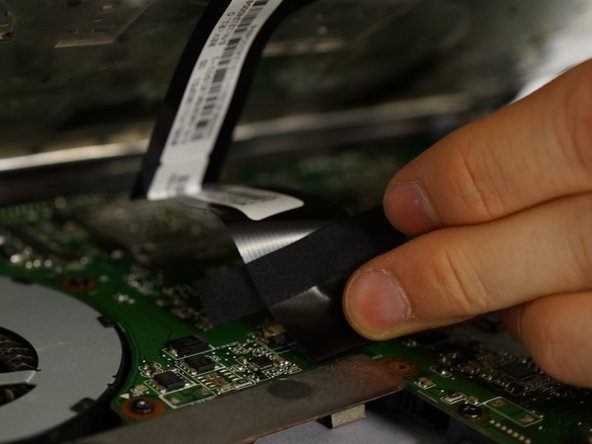

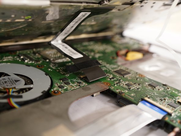

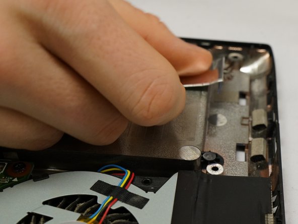

    • Pull up on the black ribbon connection on the audio board. The board will lift out of the device casting.
  12. ASUS U46E-RAL7 Audio Board Replacement: crwdns2935265:012crwdnd2935265:01crwdnd2935265:02crwdne2935265:0 ASUS U46E-RAL7 Audio Board Replacement: crwdns2935265:012crwdnd2935265:02crwdnd2935265:02crwdne2935265:0
    • Using both hands pull the audio board out by pulling towards the center of the device and then up to remove.
