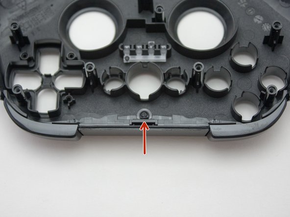

  7. ASUS TV500BG Bluetooth Controller Disassembly, Remove Buttons: crwdns2935265:07crwdnd2935265:01crwdnd2935265:03crwdne2935265:0 ASUS TV500BG Bluetooth Controller Disassembly, Remove Buttons: crwdns2935265:07crwdnd2935265:02crwdnd2935265:03crwdne2935265:0 ASUS TV500BG Bluetooth Controller Disassembly, Remove Buttons: crwdns2935265:07crwdnd2935265:03crwdnd2935265:03crwdne2935265:0
    • First we'll tackle the top half of the controller case. If you enjoyed pulling the weights out, get excited. This is pretty much the same.
    • There are membrane switches under the plastic buttons. First lift out the membrane switches, then the buttons.
    • If you're careful you can just flip the controller case over and the buttons will fall out.
    • You cannot remove the bumper buttons without breaking the plastic hinge that holds them (shown in the last photo). If you need to replace these buttons I suggest carefully cutting off the top of the hinge to remove the old buttons. Then you can use a dab of hot glue or something similar to hold the new ones on.

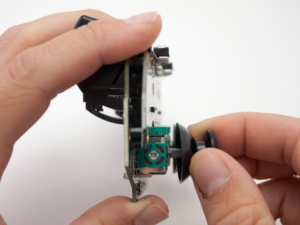

  8. ASUS TV500BG Bluetooth Controller Disassembly, Remove Joysticks: crwdns2935265:08crwdnd2935265:01crwdnd2935265:02crwdne2935265:0 ASUS TV500BG Bluetooth Controller Disassembly, Remove Joysticks: crwdns2935265:08crwdnd2935265:02crwdnd2935265:02crwdne2935265:0
    • Now back to the logic board. Flip the board so the joysticks are facing you. Firmly pull each joystick straight out, away from the board, to remove.
