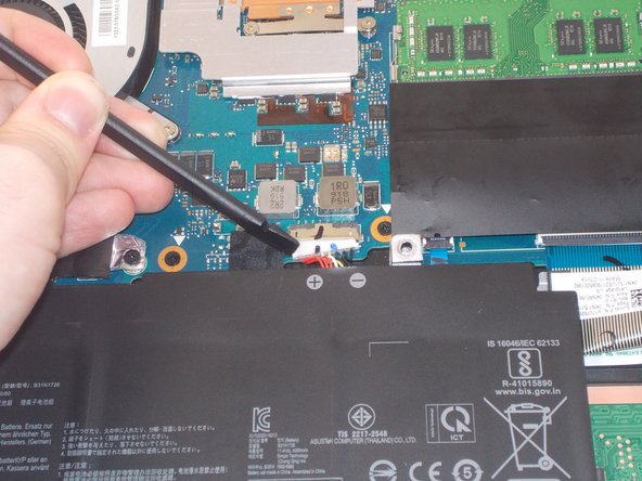

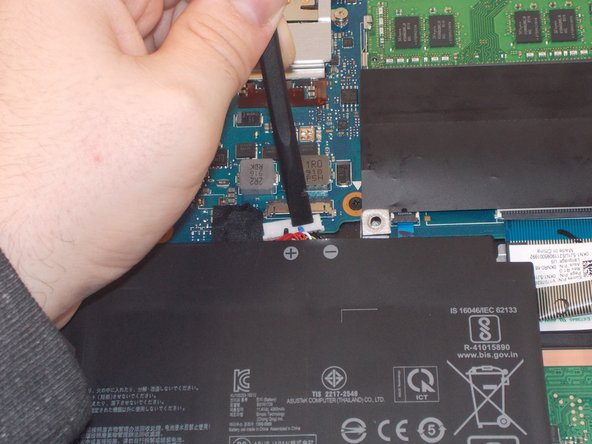

  5. ASUS TUF Gaming FX505DY Speakers Replacement, Battery: crwdns2935265:05crwdnd2935265:01crwdnd2935265:03crwdne2935265:0 ASUS TUF Gaming FX505DY Speakers Replacement, Battery: crwdns2935265:05crwdnd2935265:02crwdnd2935265:03crwdne2935265:0 ASUS TUF Gaming FX505DY Speakers Replacement, Battery: crwdns2935265:05crwdnd2935265:03crwdnd2935265:03crwdne2935265:0
    • Using an ESD-safe spudger, disconnect the battery connector by pulling the plug away from its port.

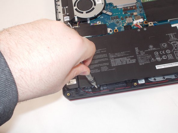

  6. ASUS TUF Gaming FX505DY Speakers Replacement: crwdns2935265:06crwdnd2935265:01crwdnd2935265:02crwdne2935265:0 ASUS TUF Gaming FX505DY Speakers Replacement: crwdns2935265:06crwdnd2935265:02crwdnd2935265:02crwdne2935265:0
    • Remove the 6 mm screw holding the battery in place using a Phillips #1 screwdriver.
    • Avoid cutting, puncturing, or otherwise damaging the battery. Li-ion batteries can combust or explode if damaged.

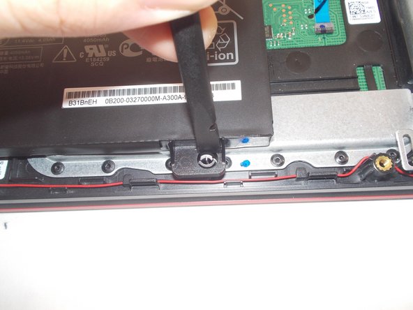

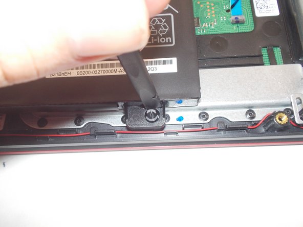

  7. ASUS TUF Gaming FX505DY Speakers Replacement: crwdns2935265:07crwdnd2935265:01crwdnd2935265:03crwdne2935265:0 ASUS TUF Gaming FX505DY Speakers Replacement: crwdns2935265:07crwdnd2935265:02crwdnd2935265:03crwdne2935265:0 ASUS TUF Gaming FX505DY Speakers Replacement: crwdns2935265:07crwdnd2935265:03crwdnd2935265:03crwdne2935265:0
    • Use a spudger to pry the retaining pin into the closed position to allow the battery frame to be removed.
  8. ASUS TUF Gaming FX505DY Speakers Replacement: crwdns2935265:08crwdnd2935265:01crwdnd2935265:01crwdne2935265:0
    • Lift the battery up out of the computer.
