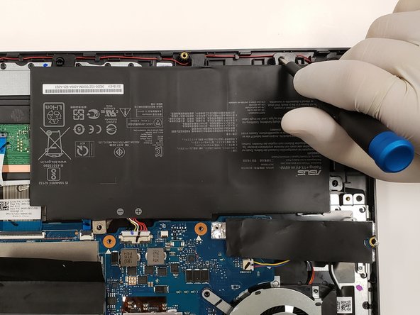

    • Use a Phillips #1 screwdriver to remove the five 6 mm screws that secure the back panel.
    • Use the same screwdriver to remove the six 13 mm screws securing the back panel.
  3. ASUS TUF Gaming FX505DY Keyboard Replacement: crwdns2935265:03crwdnd2935265:01crwdnd2935265:02crwdne2935265:0 ASUS TUF Gaming FX505DY Keyboard Replacement: crwdns2935265:03crwdnd2935265:02crwdnd2935265:02crwdne2935265:0
    • Insert the plastic opening tool at a corner and pry up along the edges, leaving the back side with the hinges for last.
    • Do not insert the opening tool too far into the laptop to avoid damaging internal components.
  4. ASUS TUF Gaming FX505DY Keyboard Replacement: crwdns2935265:04crwdnd2935265:01crwdnd2935265:02crwdne2935265:0 ASUS TUF Gaming FX505DY Keyboard Replacement: crwdns2935265:04crwdnd2935265:02crwdnd2935265:02crwdne2935265:0
    • Gently lift up the back panel to release any remaining clips on the side with the hinges and remove the panel.

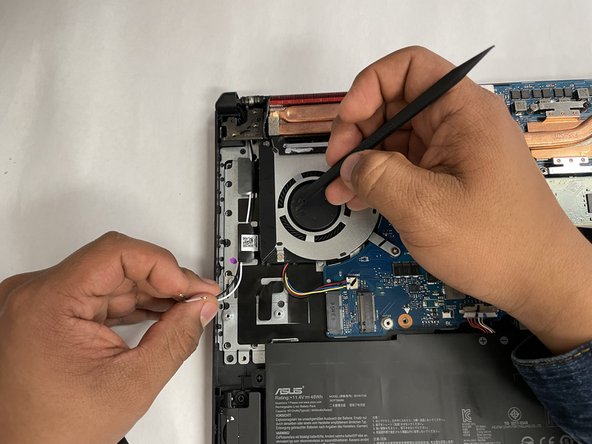

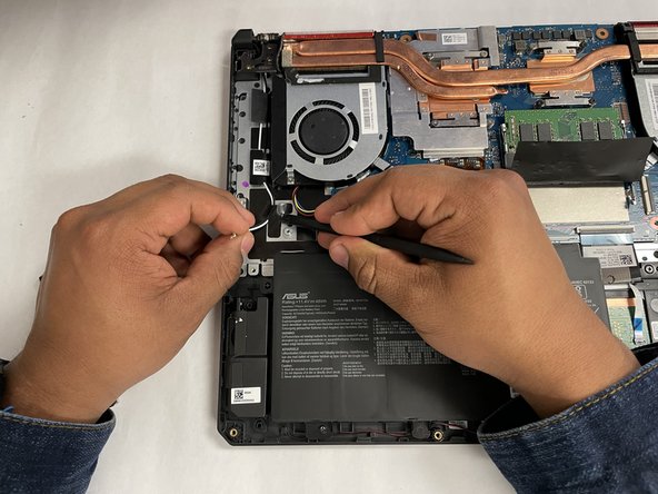

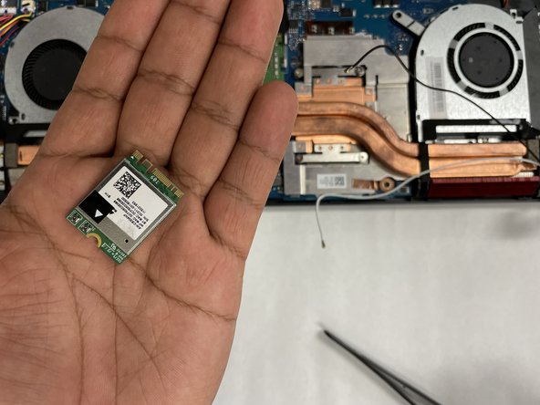

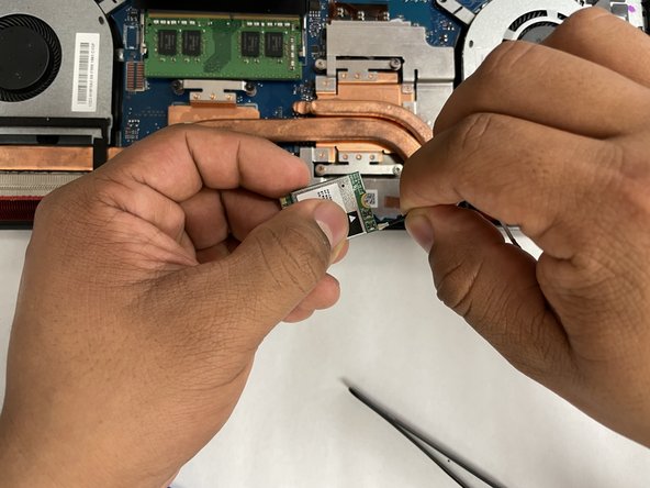

  5. ASUS TUF Gaming FX505DY Keyboard Replacement, Display Assembly: crwdns2935265:05crwdnd2935265:01crwdnd2935265:03crwdne2935265:0 ASUS TUF Gaming FX505DY Keyboard Replacement, Display Assembly: crwdns2935265:05crwdnd2935265:02crwdnd2935265:03crwdne2935265:0 ASUS TUF Gaming FX505DY Keyboard Replacement, Display Assembly: crwdns2935265:05crwdnd2935265:03crwdnd2935265:03crwdne2935265:0
    • Disconnect the white and black wires from the Wi-Fi chip
  6. ASUS TUF Gaming FX505DY Keyboard Replacement: crwdns2935265:06crwdnd2935265:01crwdnd2935265:03crwdne2935265:0 ASUS TUF Gaming FX505DY Keyboard Replacement: crwdns2935265:06crwdnd2935265:02crwdnd2935265:03crwdne2935265:0 ASUS TUF Gaming FX505DY Keyboard Replacement: crwdns2935265:06crwdnd2935265:03crwdnd2935265:03crwdne2935265:0
    • Remove the white and black wires from the black tape.

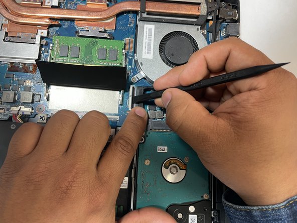

  7. ASUS TUF Gaming FX505DY Keyboard Replacement: crwdns2935265:07crwdnd2935265:01crwdnd2935265:03crwdne2935265:0 ASUS TUF Gaming FX505DY Keyboard Replacement: crwdns2935265:07crwdnd2935265:02crwdnd2935265:03crwdne2935265:0 ASUS TUF Gaming FX505DY Keyboard Replacement: crwdns2935265:07crwdnd2935265:03crwdnd2935265:03crwdne2935265:0

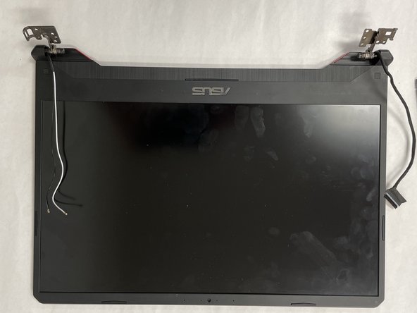

    • Unhinge and pull the display cable from the mother board.
    • The port should be labeled "LVDS" and located between the cooling fan and the hard drive.

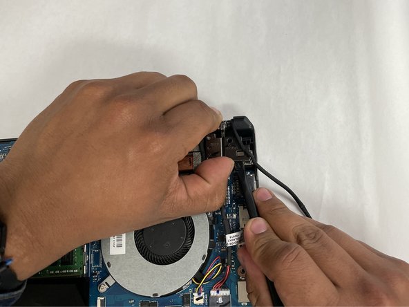

  8. ASUS TUF Gaming FX505DY Keyboard Replacement: crwdns2935265:08crwdnd2935265:01crwdnd2935265:03crwdne2935265:0 ASUS TUF Gaming FX505DY Keyboard Replacement: crwdns2935265:08crwdnd2935265:02crwdnd2935265:03crwdne2935265:0 ASUS TUF Gaming FX505DY Keyboard Replacement: crwdns2935265:08crwdnd2935265:03crwdnd2935265:03crwdne2935265:0
    • Unscrew and lift the hinge.
    • Some hinges may be tough to pull, proceed with caution.
  9. ASUS TUF Gaming FX505DY Keyboard Replacement: crwdns2935265:09crwdnd2935265:01crwdnd2935265:02crwdne2935265:0 ASUS TUF Gaming FX505DY Keyboard Replacement: crwdns2935265:09crwdnd2935265:02crwdnd2935265:02crwdne2935265:0
    • Unhinge the other side, and remove the display from the rest of the computer.

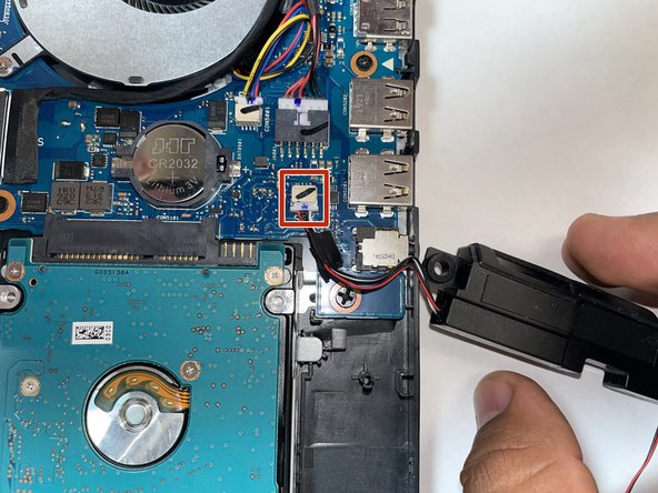

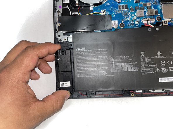

  10. ASUS TUF Gaming FX505DY Keyboard Replacement, Speakers: crwdns2935265:010crwdnd2935265:01crwdnd2935265:02crwdne2935265:0 ASUS TUF Gaming FX505DY Keyboard Replacement, Speakers: crwdns2935265:010crwdnd2935265:02crwdnd2935265:02crwdne2935265:0
    • Lift the speakers from the pegs holding them down. Use minimal force as to not break the pegs or the speakers.
  11. ASUS TUF Gaming FX505DY Keyboard Replacement: crwdns2935265:011crwdnd2935265:01crwdnd2935265:02crwdne2935265:0 ASUS TUF Gaming FX505DY Keyboard Replacement: crwdns2935265:011crwdnd2935265:02crwdnd2935265:02crwdne2935265:0
    • Identify the place where the speaker cable connects to the motherboard. The port should be "SPK"
  12. ASUS TUF Gaming FX505DY Keyboard Replacement: crwdns2935265:012crwdnd2935265:01crwdnd2935265:02crwdne2935265:0 ASUS TUF Gaming FX505DY Keyboard Replacement: crwdns2935265:012crwdnd2935265:02crwdnd2935265:02crwdne2935265:0
    • Pull the cable off the motherboard using a plastic pick or other pointed item and remove the speakers.

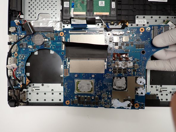

  13. ASUS TUF Gaming FX505DY Keyboard Replacement, Motherboard: crwdns2935265:013crwdnd2935265:01crwdnd2935265:03crwdne2935265:0 ASUS TUF Gaming FX505DY Keyboard Replacement, Motherboard: crwdns2935265:013crwdnd2935265:02crwdnd2935265:03crwdne2935265:0 ASUS TUF Gaming FX505DY Keyboard Replacement, Motherboard: crwdns2935265:013crwdnd2935265:03crwdnd2935265:03crwdne2935265:0
    • With a Phillips 0-bit screwdriver, remove eight 5.0 mm screws on the silver brackets
    • With a Phillips 0-bit screwdriver, remove two 5.0 mm screws holding the edge of the fans in place

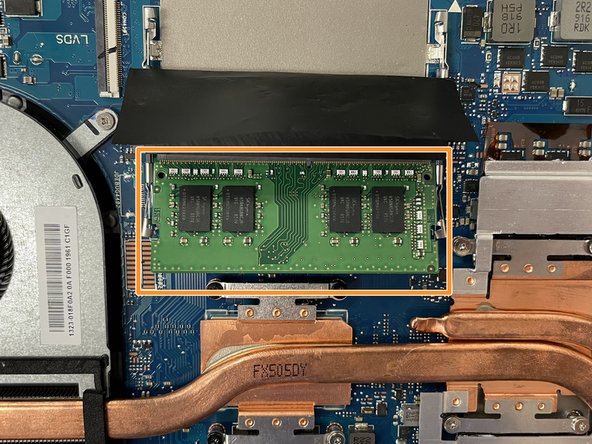

  15. ASUS TUF Gaming FX505DY Keyboard Replacement: crwdns2935265:015crwdnd2935265:01crwdnd2935265:02crwdne2935265:0 ASUS TUF Gaming FX505DY Keyboard Replacement: crwdns2935265:015crwdnd2935265:02crwdnd2935265:02crwdne2935265:0
    • With a Phillips 0-bit screwdriver, unscrew four 5.0 mm screws.
    • Disconnect the primary connector cable located at the bottom left and carefully remove the module.
  16. ASUS TUF Gaming FX505DY Keyboard Replacement: crwdns2935265:016crwdnd2935265:01crwdnd2935265:03crwdne2935265:0 ASUS TUF Gaming FX505DY Keyboard Replacement: crwdns2935265:016crwdnd2935265:02crwdnd2935265:03crwdne2935265:0 ASUS TUF Gaming FX505DY Keyboard Replacement: crwdns2935265:016crwdnd2935265:03crwdnd2935265:03crwdne2935265:0

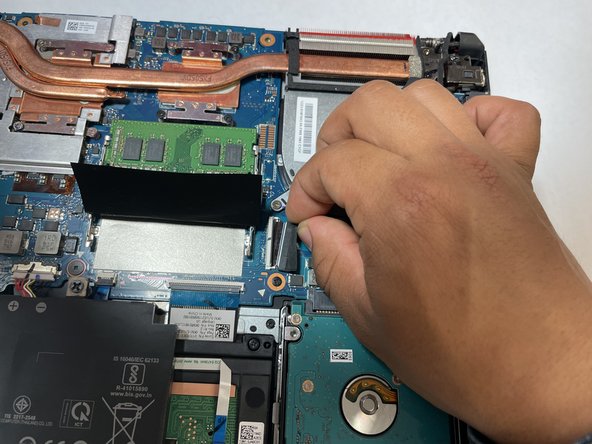

    • Removing the ram, push down unto the ram and move the metal locking tabs to the side by lifting upward slightly then moving each to their outside.
    • Pull the ram out toward the angle when the ram is sticking up at an angle when released.
  17. ASUS TUF Gaming FX505DY Keyboard Replacement: crwdns2935265:017crwdnd2935265:01crwdnd2935265:02crwdne2935265:0 ASUS TUF Gaming FX505DY Keyboard Replacement: crwdns2935265:017crwdnd2935265:02crwdnd2935265:02crwdne2935265:0
    • With a Phillips 0-bit screwdriver, unscrew four 5.0 mm top screws holding the hard drive in place.
    • Pinch the top left corner with your finger and slide the harddrive out of its casing.

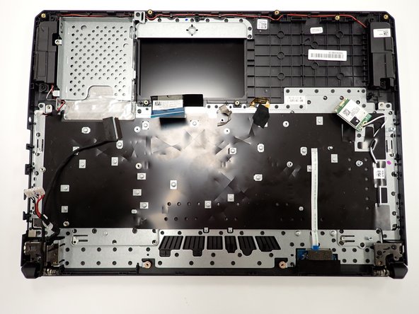

    • With a size 0 Phillips screwdriver, unscrew three center 5 mm screws securing the board in place.
    • Carefully lift the board and place in a safe area.
  20. ASUS TUF Gaming FX505DY Keyboard Replacement, Touchpad: crwdns2935265:020crwdnd2935265:01crwdnd2935265:03crwdne2935265:0 ASUS TUF Gaming FX505DY Keyboard Replacement, Touchpad: crwdns2935265:020crwdnd2935265:02crwdnd2935265:03crwdne2935265:0 ASUS TUF Gaming FX505DY Keyboard Replacement, Touchpad: crwdns2935265:020crwdnd2935265:03crwdnd2935265:03crwdne2935265:0
    • With a size 0 Phillips screwdriver, unscrew two 5 mm screws holding the trackpad in place located at the bottom of the trackpad.
    • Carefully unclip the connector base to remove the two touchpad cables.
    • Remove the trackpad by sliding forward and lifting up.

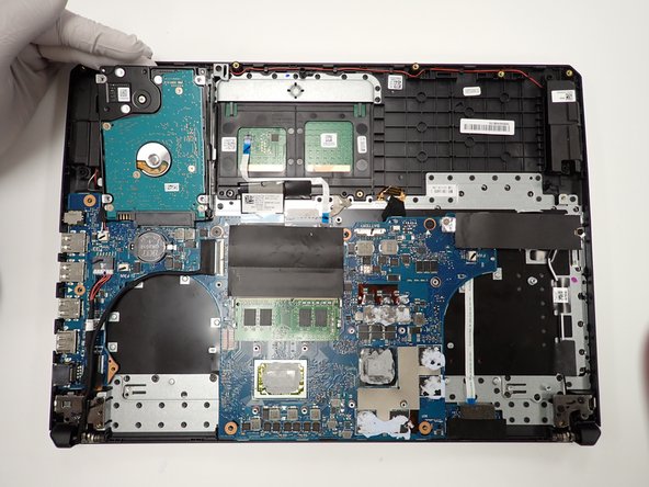

  21. ASUS TUF Gaming FX505DY Keyboard Replacement, Keyboard: crwdns2935265:021crwdnd2935265:01crwdnd2935265:01crwdne2935265:0
    • The keyboard is the entire body without any of the other parts attached. Do not try to remove the metal plate from the body.
